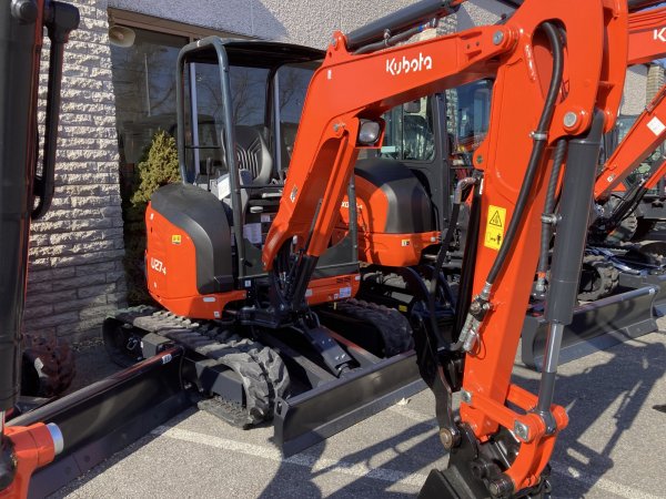

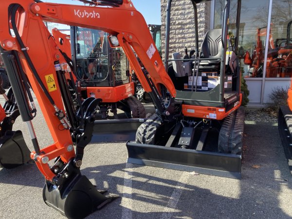

    You inspired me so much I took a drive this morning and wrote a check to my Kubota dealership! Like you all my toys are large Tonkas.
    Here’s a picture of the U27 I bought.
