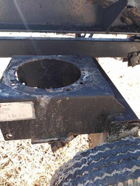

    I have a Northern tools wood splitter that is about 17 years old. It had a 5hp tecumseh verticle shaft engine. The engine seized on me the other day and I'm going to have to replace it. My problem is finding an affordable verticle shaft engine is difficult. I found one at harbor freight but the shaft rotation is counter clockwise and my pump rotates clockwise. I could put a horizontal shaft engine on it but the original mount is above the hydraulic tank. My question is does the pump have to be below the fluid level in the tank or does a pump self prime? If I have to I can rebuild the original mount to drop the engine and pump down but if I don't have to I'd rather not. Thanks for any advice.

    I never thought about it before, but on my modified log splitter the pump is above the hydraulic reservoir. Never had any problems (now that I say that watch next time I use it!!). I'd weld a plat over that hole, mount a horizontal shaft engine on it, weld a bracket to hold the pump at appropriate place with Lovejoy connector connected.

    I put that 6.5hp predator on the Didier splitter that had a 5 hp Briggs on it. So much better in every way. But that was an easy swap. Horizontal to horizontal.
    My MTD looks like your splitter's construction. 5 hp Tecumseh vertical on it. I want to put a 6.5 horizontal predator on this one and maybe brenny's HO pump upgrade too. Then put it on a trailer and do the walt style conversion.

    I'm pretty sure that Dangit Karl has the same splitter as I do. Post up an entire picture of it, and that'll confirm it. If not, it's similar enough to do 2x any fabbed parts on for the motor plate. The pump bracket with all the associated coupler parts are easily purchased too.
