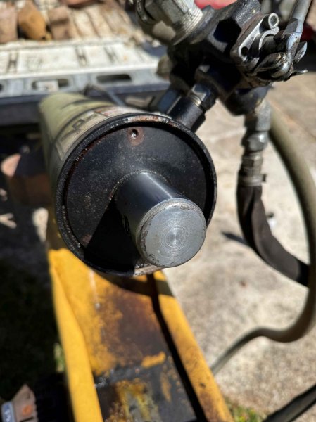

    Hello, Countyline 25 ton splitter leaking where the rod comes out of the cylinder. Has been fifty years since I have dealt with hydraulics but I was able to get into it, removed the retaining ring and was able to remove the gland that holds the seals. Actually, once I got the retaining ring off, I applied a little pressure at low throttle to the ram and it shot the gland out, lol. I notice that there is a hole at the edge of the gland like a screw should be there. But there is no screw. If you know that there should be a screw there, advise, lol.

    pictures of the hole you are talking about would be great. There are many different types and styles of gland and it would be foolish of us to assume it was any particular one.

    Oh, I forgot about the hole question...if it's about a 1/4" hole right out by the edge, there's supposed to be a bolt with a fender washer in there...it's meant to keep the gland pulled out against the snap ring...not real yet important once things are full of oil IMO, unless you transported it in a vertical position maybe?

    That hole I spoke of, I have now found a video and I saw the same hole on his identical splitter. It appears to be a tad over 1/8" diameter. So, since I saw it on his, I suppose it's just a hole, lol. It's right next to the edge of the gland. I am going to Tractor Supply today and when there will look at one of these, they still sell this splitter, maybe they are still the same.
    Here is a pic below. In this pic, it appears larger for some reason, some kind of optical illusion.
    EDIT: In the video I mention below, in the comments, somebody asked him about this very hole. His reply: "I know exactly the hole you’re talking about. It doesn’t go through the plate and I’ll be honest I have no idea what the hole is for. My guess would be something connected to the manufacturing of the plate."
    EDIT 2: The video I watched, I am watching again (linked below in case anyone needs to see this in the future), it is this same Countyline splitter and his DID have another gland deep inside (or similar to a gland), on the other end of the rod. At the very end of the rod (the end deep inside the cylinder) there was a large nut and then something that looks like the gland that is snugged up next to that nut. If that contains seals, wondering if I should also replace them. I will watch again to make sure.
    EDIT 3: And another edit! I found this comment on youtube by a poster on this linked video, concerning the mystery hole, and also the piston on the end of the rod. In this thread I refer to it as appearing to be another gland? But it's the piston? Okay, makes sense. So here are the comments: "I have been watching some other videos on how to replace the seals and one of them showed that the end piece (piston?) that you tried so hard to get off of the rod was actually welded on to the rod, even though it still had the big nut on it. Maybe yours was welded on too? Also, the threaded hole on the outside (front face) of the front part of the rod is supposed to have a screw in it, with a large fender washer under the screw. The washer overlaps over the end of the big 4" cylinder a slight amount. That is there to keep the front part of the metal piston from going into the cylinder. The cylinder (I guess piston is correct word?) on my splitter does indeed have that screw and fender washer on it." (Yawner's note: I think he means gland not cylinder.)
    So, now I am again concerned about that hole that has no screw and fender washer. How could I figure out what to buy, and where!
