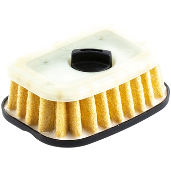

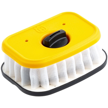

    I have bought two maintenance kits for my two Husqvarna 460s from Amazon. Comes with the nylon filter, spark plug, fuel filter, and two stroke oil. I have been using the same nylon filter for almost two years now and it is holding up very well. I blow it out every second cutting day and then soak it in hot soapy water every two or three weeks. So you get your money's worth out of the nylon filter. It is easy to see if the nylon filter requires cleaning, not so much with the felt.
  4. isaaccarlson
    isaaccarlson
    Sep 29, 2014
    1,007
    4,905
    Colfax, WI
    The nylon filter can be cleaned but the felt will only get more clogged, even if you try to clean it, but it will usually catch finer stuff. I switched to nylon filters and see better power because of it. Oem, not china pos. I tried china and they leaked fines into the intake. Oem is great.
    MaineMtnMan, Screwloose and WESF like this.
  5. The Wood Wolverine
    16,227
    100,349
    I run the nylon on my ported saws. They flow a bit more freely. I keep my chains throwing large chip so I don’t really worry about fines getting ingested. Felt will filter to a smaller micron number (I do believe)..I’ve washed felts plenty of times.
  6. isaaccarlson
    isaaccarlson
    Sep 29, 2014
    1,007
    4,905
    Colfax, WI
    I washed mine a bunch too, but every time I washed them, more stayed in the felt and would not come out. Great filters, but they do tend to get more restrictive over time.
  7. In the Pines
    In the Pines
    Sep 3, 2018
    1,392
    7,684
    I thought I read once upon a time the felt filters were better for dry dusty conditions since they trap more.
    They also clog faster. The nylons are better in colder conditions. maybe I'm imagining it too.
  8. isaaccarlson
    isaaccarlson
    Sep 29, 2014
    1,007
    4,905
    Colfax, WI
    That's what the stihl book says. The nylon is much easier to clean.
    WESF, Screwloose and In the Pines like this.
  9. Ronaldo
    Ronaldo
    Jul 17, 2015
    1,413
    8,217
    Nylon is designed for cutting green wood where there will be less chance of finer dust particles. The felt is a finer filtering media for dry, dusty conditions.
  10. The Wood Wolverine
    16,227
    100,349
    Yep. :handshake:
    WESF, Ronaldo and In the Pines like this.
