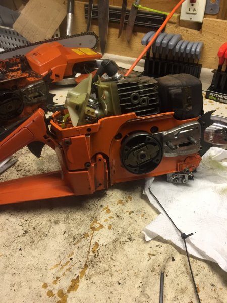

    55B72A7F-71AA-4A1B-81FF-DDBEDBEB7EC1.jpeg over the summer I got 3 x 55’s and 2 x 51’s and they’ve been sitting in bins under the bench since. Pulled them out this afternoon to take a look at what’s there. After compressions tests on those with cylinders and eyeballing the clean up effort on each, I’m going to take a 55 top end with 165 #’s and match it to a really clean 51, which came with nothing north of the base gasket.

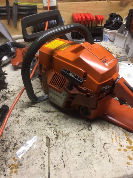

    6E3C60E0-D788-4FCA-A6F3-C66DFB063D94.jpeg C12492C0-148F-410E-B401-BF994646F925.jpeg FE3B69C5-E63C-499D-A7EF-29ED87934C41.jpeg Got through it this afternoon. Sequence above is off, but you get the idea.
    Things looking good!
