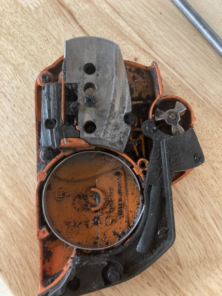

    There is a nylon piece that looks like it is replaceable and has a lot of wear. What is it called and where can I order a new one. What is the purpose of it.

    Can you post a pic? Might be a chain guide.

    It is in the upper left corner of the pic

    Yes chain guide.

    I purchased one (a Chinese copy) on Ebay. For the same saw. Fits good, works good, cheap.
