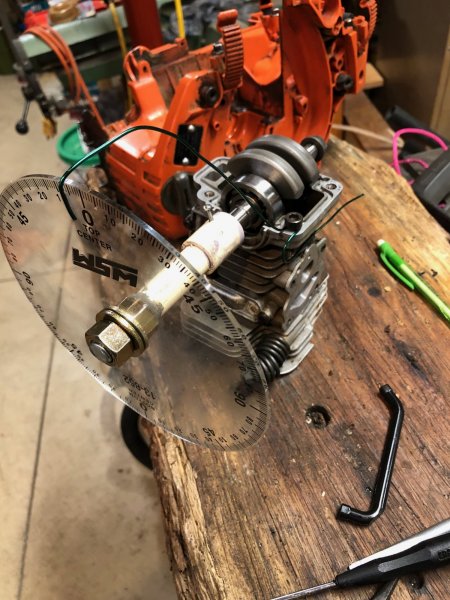

    I checked the numbers:
    exhaust opens @ 105* ATDC duration of 150*
    x-fers open @ 117* ATDC giving it a blowdown of only 12*
    intake opens @ 71* BTDC for a duration of 142*
    exhaust port is 20mm wide in a 42mm bore

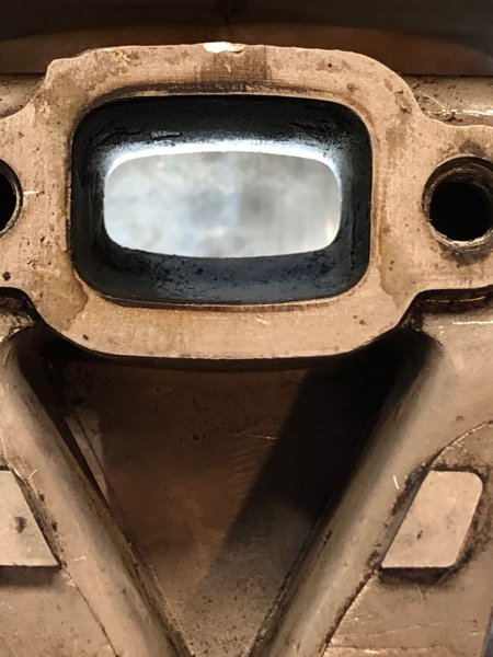

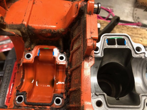

    Lower x-fer openings match up to the lower crankcase alcove pretty well, both are 20mm wide side to side (blue marks) and match up well at the outer edge of the crankcase (green marks). Those edges will not get touched.

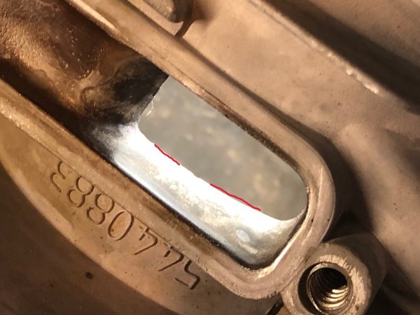

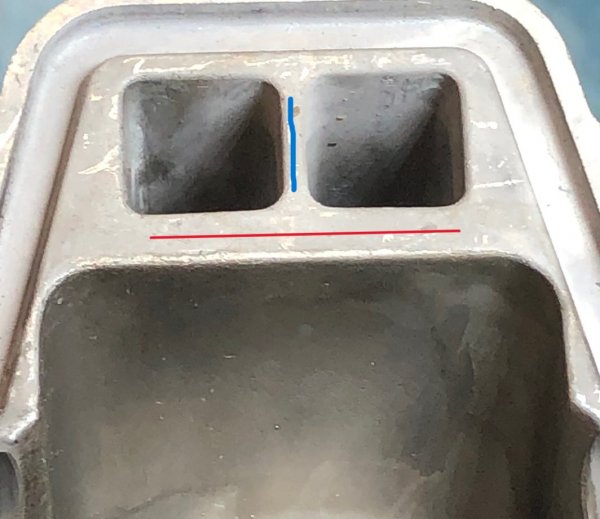

    The upper transfer roofs are angled a little downward and the roofs will not get touched because the blowdown is already very short. There is a slight burr or plating bulge along the roof of the upper x-fer that I can catch the tip of a small screwdriver on in places. I will take a very small diamond flat file to eliminate that imperfection at the cylinder wall to reduce any drag in the flow at that point. This picture shows the roof of the transfer (the bottom edge in the pic) angles towards the middle of the transfer port on the other side of the cylinder. It's not a lot of angle but just wanted to note that it isn't flat or 90* to the cylinder wall.
    The red mark is the x-fer roof edge that has the slight imperfection. You can't really see it but you can feel it and even catch a tool on it. This will get eliminated and just a slight chamfer on it. this port isn't very wide so the ring can't flex into it very far so there is a low risk of hanging in this port unlike a WIDE exhaust port that is too flat across it's roof.

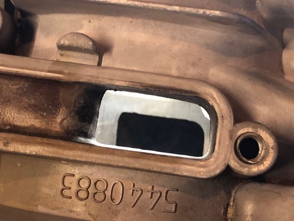

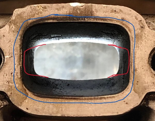

    EXHAUST
    The exhaust port will get widened. If it wasn't a clammy, I'd have the base and squish cut, raise the exhaust roof and lower the upper transfers to get some more blowdown. But on a budget, that's not an option.
    I'm thinking widening to 27 or 28mm keeping the arc going with rounded corners (I was a draftsman, not an artist, pardon the crappy markings in the pix). Then when lightening the piston, putting a matching arc on it so it opens much wider to let more high pressure gases out quicker before the transfer ports open. I did the piston arc to match the exhaust port on my 357 and that saw runs ok. I'll blend the inner port to the opened up outer side of the port as well, then match the gasket, heat shield, and muffler opening to it.

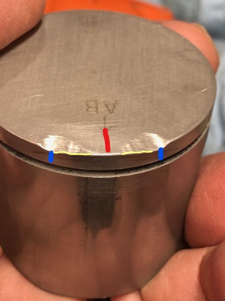

    Here's the piston arc I did on the 357 and I'm planning the same on this saw only maybe a little wider. I just don't want to get too close to the ring groove but I want it to match the port roof for as wide as I can. This mimics having a flat exhaust port roof without the risk of hanging a ring.
    Not a great pic but hopefully you get the idea.

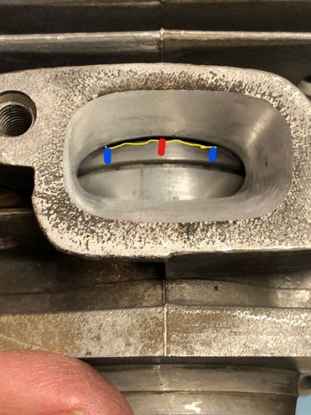

    INTAKE
    Duration seems kinda short to me, but I'm not sure of all the relationships that may get shifted when the strato ports come into the picture. I have increased the intake duration to upper 150's or even to 160 on the couple of non strato saws that I've done but with this being a strato AND having very short blowdown, I'm thinking that increasing it too much will to little to improve performance but may do a lot to just dump unburned mix out the exhaust.
    I plan on blending it a little wider, but not lowering the intake floor. The strato ports in the upper part of the pic will not get touched. While lightening the piston I will shorten the skirts about 1.5mm to gain duration instead. Adding duration is on hold till I learn more about the blue piston port that I have questions on below.

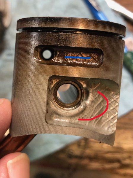

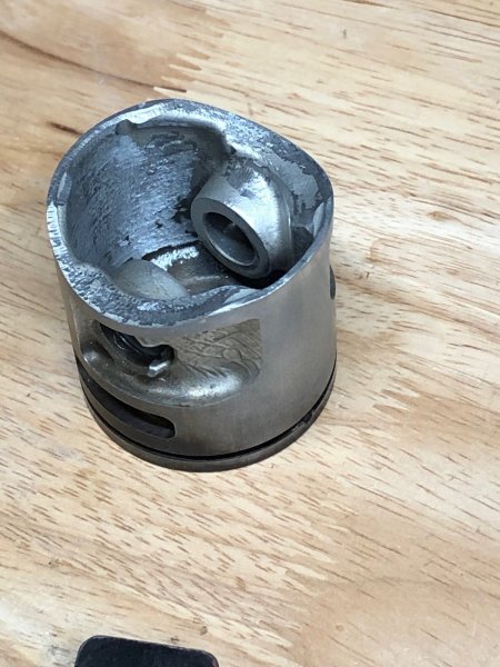

    PISTON
    The skirt on exhaust side of the piston can be shortened to match the intake without free porting. I am planning on taking a few grams off the piston. This pic is the 445 piston. More on lightening it later when I have a little more info in my head.
    I have questions on this.
    The area with the red mark I understand. That opens the strato ports to the upper bypass ports so straight air can be loaded down the transfer tunnels a little way so the first part of the charge entering the combustion chamber and exits the exhaust port is straight air as opposed to fuel / air mix that won't get stuffed back in since there is no tuned pipe on a saw. That function of the strato design to save gas and lower emissions I get... not like a pro porter or good engine builder, but enough to know why they are there and how they work.
    The area marked in blue I'm not quite sure about. I have a couple guesses but that is all they are... I'm hoping someone who understands its' function steps in and enlightens us about it. I would like to understand it better before lightening this piston to the point of making something not work as intended. If not, I will just not go crazy on the piston...
    As the piston is going up in compression the blue area short circuits the upper transfer port to the crankcase right before the strato ports are opened to the transfer ports by the red area. And as the piston is coming down in the power stroke, the blue area opens the upper transfer port to the crankcase via the hole in the piston after the stratos charged the upper transfer tunnels with air. I see what it does, but I'm not sure what purpose it serves and how this timing and the size of the hole in the piston acts to improve the functionality of the saw.
    Two stroke basics I kind of understand and I even get the strato stuff that blew me away when I first encountered them, but this blue piston port thing is over my head at this point and I would love to learn more about it.

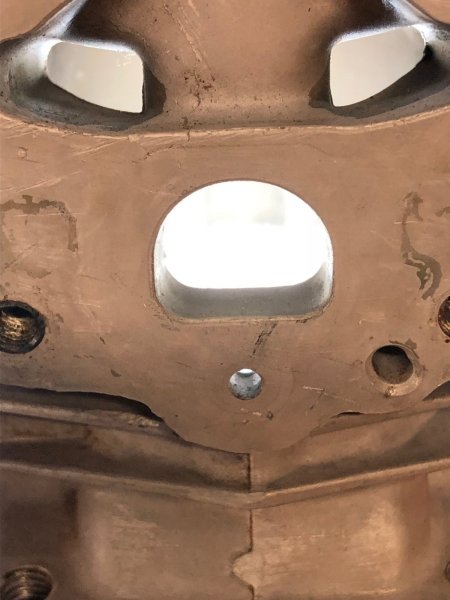

    LOWER X-FERS
    Access to the lower transfers as the piston compresses the mix down into the crankcase looks to me like the mix has to make a 180* transition up into the transfer tunnels around 2 90* corners. I'm thinking that knife edging the divider between the two tunnels (blue mark) is a start and rounding the 2 edges from the crankcase at the entrance (red line) would be helpful while not increasing crankcase volume very much.

  9. MAF143
    MAF143
    Dec 8, 2018
    1,697
    11,902
    North Central OH
    You're seeing it just like I saw it... No metal bottom. not a mag source... :(
    12* blowdown gave me a double take also... I measured it several times, had another beer and measured it again...

    The area of the piston that I was questioning (marked in blue above) is just a void to shed piston weight. Turns out I was way overthinking again... The red void as mentioned is the Strato port to transfer tunnel pass through link. I did find some other port jobs on the internet on the 450 big brother to this saw. I'm getting a better fix in my head of where I want to go with this cylinder and piston. It's been a busy day today and work is demanding 10-12 hour days this week, NO FUN... All work and no play makes Monte a dull boy...

    1. Widen exhaust, blend and match muffler opening as described above. Of course a muffler mod.
    2. Arc on the piston crown to match the exhaust port roof.

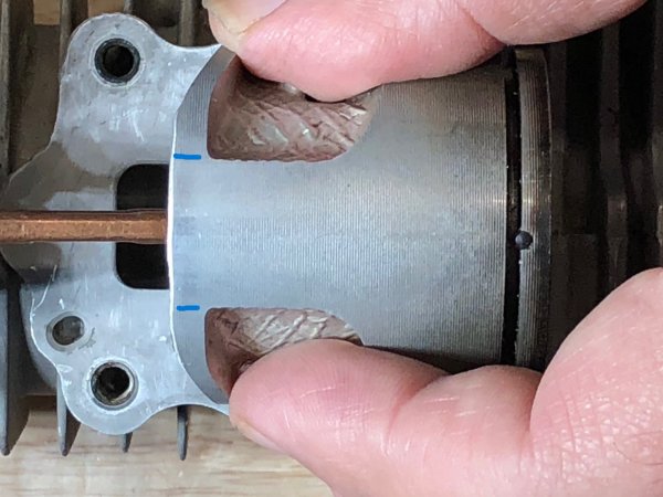

    Trimmed the piston skirts and cut some flash off the inside of the piston. The skirt is marked with my target to grind off. I ended up with the intake timing going from 71* with a 142* duration to 77* with a 154* duration.
    This raises a question for me though with this being the first strato port saw that I have ever messed with the intake timing. I'll have to sit down and go through the cycles with the timing wheel and think through the relationship between intake port opening to the crankcase vs. the intake timing of the strato window of the piston opening to the upper transfer port of the cylinder to insert ex purge air into the tunnels. At first take, I'm thinking I should raise the strato window on the piston the same amount that lowered the intake (6*). The raising of the strato window (in my brain) isn't really to improve overall performance, but to maintain the strato's objective of saving gas and lowering emissions. But if you open it too much it would hurt performance.
    So if this thread ends abruptly, you can assume my brain exploded thinking about this relationship...
    Skirts and innards of the piston after lightening it up some.

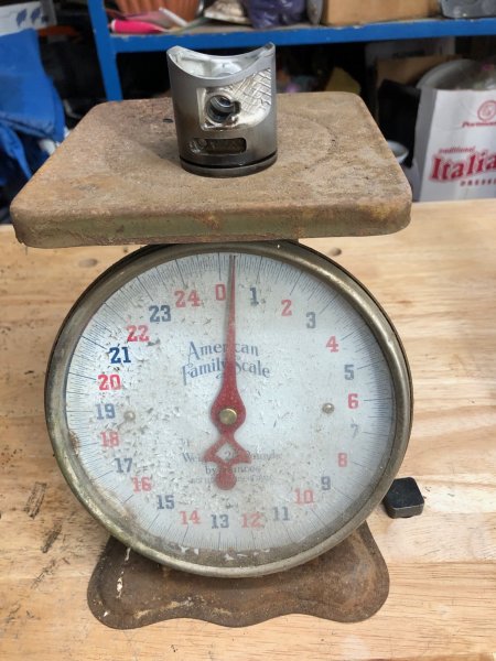

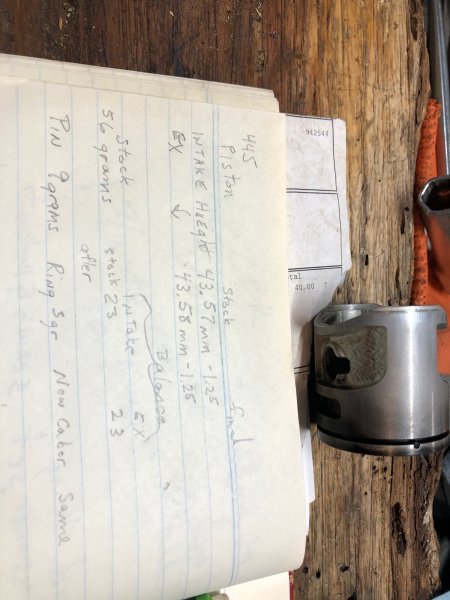

    Piston weighed in at 56 grams stock. I was only able to take off a single gram where I feel comfortable with keeping strength and longevity of the piston. This is a working firewood saw after all.
    I couldn't let the wife see me using her nice scales in my shop!!!
