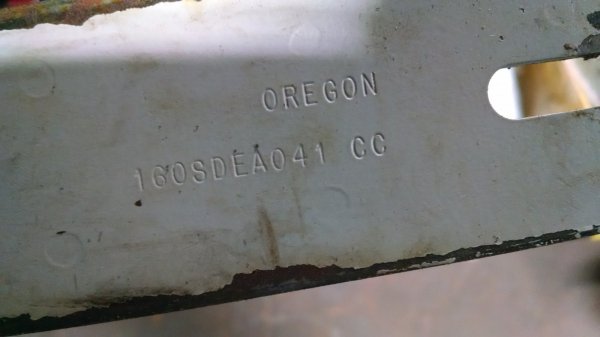

    I don't have a good pic of the bar other than when I was trying to ID it. I left everything at work, so I'll get a pic Monday.

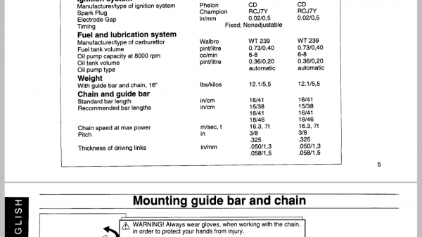

    Spec for the saw

    160SDEA041 is 3/8 LoPro .050, probably 56 DL. And does it look rough! I dunno if you can dress the rails down enough to get smooth chain flowing. The chunk rusted out under DEA0 looks troubling. But I'd try grinding/heavy grit sanding rails smooth and see if you have enough driver depth left.

    Without some serious help, that bar is toast. It's supposed to be .050, but a .058 fits right in it. .050 gauge will pivot about 30* when in the channel...maybe someone can make a machete out of it? Even if I could close it up and dress it, I'll bet the temper is long gone out of the steel from being hot.

    Guessing it oils through the unused adjuster hole. I have an older Echo that works that way.
    It's not a great pic, but I would guess that's just missing paint.

    If the channel is wallowed out, waste no time and recycle it.
