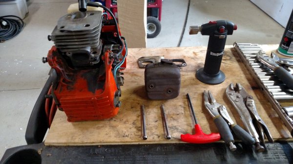

    So I started the tare down today....

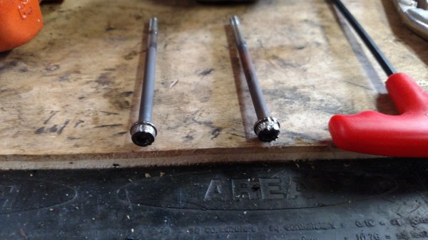

    These saws are prone to having the muffler rattle off.....but noooooo....not mine......actually stripped the Allen heads....so out came the vise grips....and a little bit of heat. So now I need new bolts ! But...whats done is done I guess ! They sell complete muffler kits....that include a front brace btacket...for cheap . IMG_20160119_134518846.jpg IMG_20160119_134523161.jpg

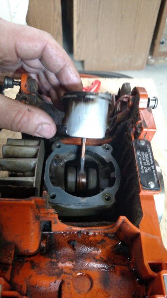

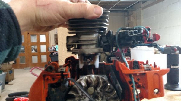

    Decided that it looked easier for me to just pull the cylinder off with carb attached....Disconnected the wires at the coil...and off with the whole deal ! Piston looks burnt..and scuffed. Definetly a chance to use a Meteor setup ! The cylinder.....well...I think it'll clean up....but won't be upset if I have to buy a 346 kit ;) IMG_20160119_135840109.jpg IMG_20160119_135923699.jpg IMG_20160119_135957027.jpg IMG_20160119_140010659.jpg IMG_20160119_140033728.jpg

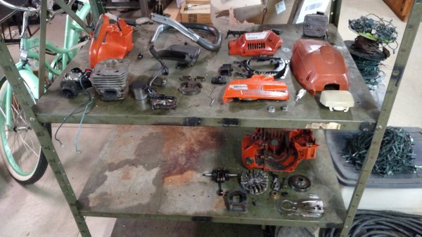

    And here it is...an empty...DIRTY ...bare carcass !! I obviously have alot of cleaning to do !! IMG_20160119_143725774.jpg
    I tried to keep everything as organized as I can.....I took about 50 pics too lol !! IMG_20160119_143800022.jpg
