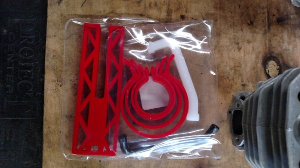

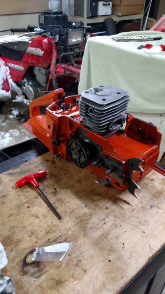

    I wasn't gonna do a thread on this...but why not..took a bunch of pics to jog my memory ....so might as well share !

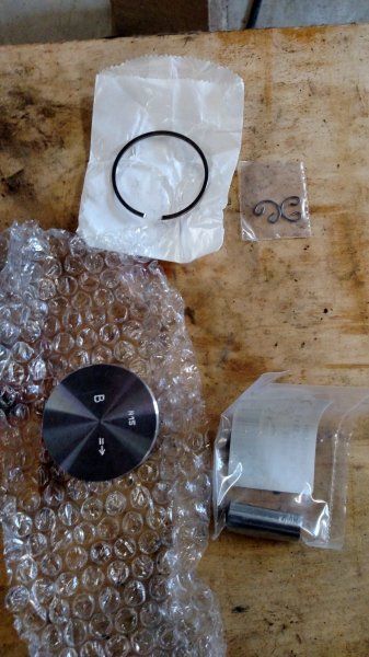

    So this is my cousins 262xp. He was given it as a gift..brand new..long time ago. . He cleared his property..and cut a crap ton of firewood with it over the years. So just this past fall....his gas cans got mixed up...and this old girl got the straight gas treatment :( He said he ran 2 tanks through it before he realized it. So.....I told him no problem...I can help ! So....tore it down...Luckily...no bottom end damage....but it transfered some of the piston onto the cylinder :( So after alot of cleaning.... Alot of emery cloth...scotch bright...and Old040's help....I got the old cylinder in decent shape. Only some small stuff on the exhaust side that I couldn't get as good as I wanted...so fingers crossed ! Fast forward past all the cleaning and disasembly....to today. Assembly time ! New Meteor piston assembly....even sprung for this new handy dandy ring compressor kit ! I highly recommend...it worked awesome !

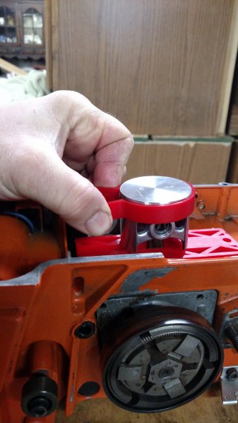

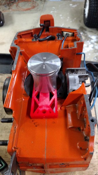

    Using this compressor kit is sooo easy..and handy !
    This pic was after I lubed up the crank bearings...lower rod bearing...upper rod bearing and piston pin ! After the pic..the piston....ring...and cylinder got lubed up nicely !!! IMG_20160121_165230640.jpg IMG_20160121_165139843.jpg

    Did I mention..that this ring compressor kit is a must ? :). So easy...a fella like me can use it ! IMG_20160121_170801415.jpg
    Coming together nnicely.....back in my comfort zone !! P.S...been emailing and sending pics to Old040 this whole time...so he could help keep me on the right track ! Thanks again buddy !! IMG_20160121_182325445.jpg

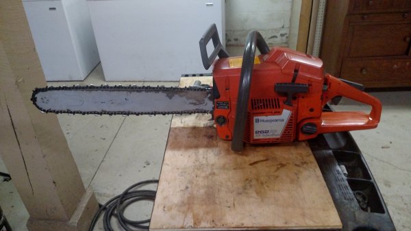

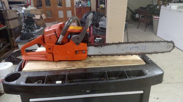

    Looking good ! All went back together nicely. Learned alot ! Definetly so much better to have a buddy online.....and everything supper clean for assembly ! IMG_20160121_185203478.jpg

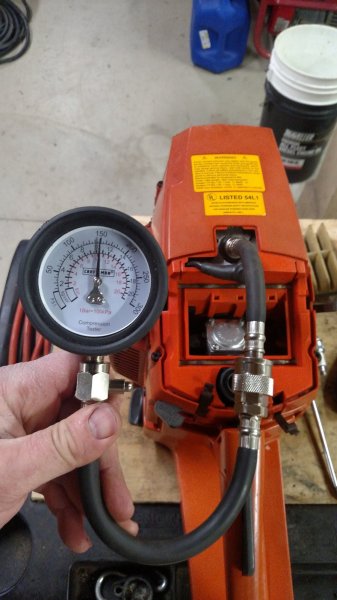

    150 PSI? Did you use a base gasket?

    Guess what.....fired up in about 8 pulls !
    Running good so far ! Let it idle about 5 minutes or so..blipped the throttle a tad...seems good ! But that's it for tonight. Hope compression goes up in a few tanks ! I'm a happy camper !

    Too clean lol ! Almost hated to use that shiny piston !!! I did use a base gasket...I was told that the 262xp has to have one..unless machine work is done to the cylinder . But I never checked squish...cuz I don't know how ....but hope to soon !

    You can take material off the bottom of the cyl with sandpaper and a piece of glass. I got my first one down to .020/.020/.020/.021 very easily.

    If ya do enough digging on these forums, you will find out how to test squish using solder and grease.
    I dropped the base gasket and sanded the cyl on my first 262 and got 175PSI before it ever ran. Is much stronger now.

    I felt the same on the comp reading, by the time fuzz got to that point I was already lay'n low for the evening, pretty sure Fuzz didn't check the squish, so we'll both have to get together and see what's up with the compression....may also be a bad decomp valve

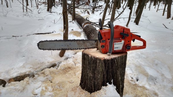

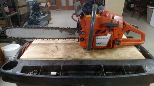

    Running really well ! Still holding about 150 psi after two tanks...so I may have to look into this ..... IMG_20160122_090835185_HDR.jpg
    And yes...I tightened the chain after the pic lol !
