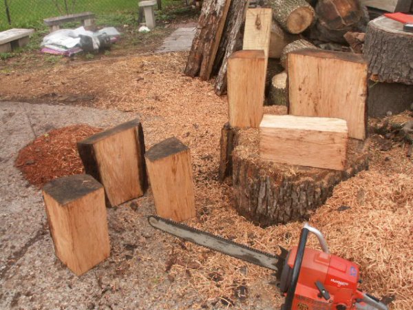

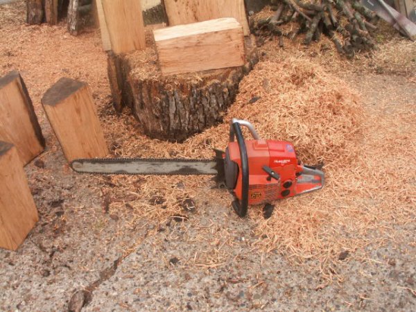

    Seems to be fine now,1 pull it pops when cold,2-3 pulls its running.Occasional backfire during a heavy cut,that never happened before.Not sure if that means misfiring or what. Gonna put a carb kit on it pretty soon anyway,it could probably use one by now.
