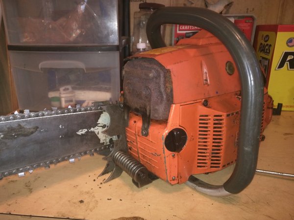

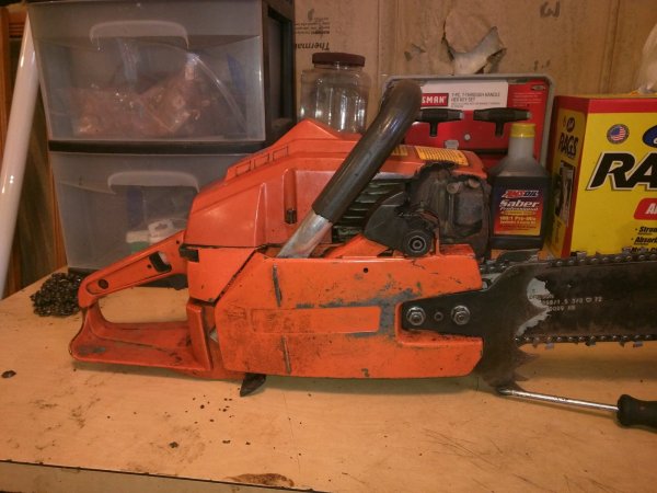

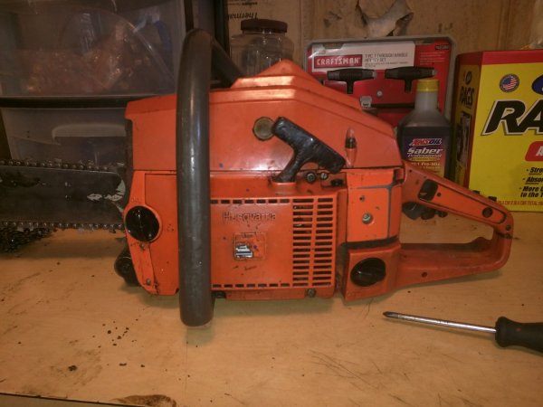

    Ok need a little help here. Can someone help me identify the husky I bought today lol. Yes I know I know that you all are thinking " he bought a saw with out knowing what it is ". Well I have some ideas on what it is, but the name plate is gone and the badge on the recoil is mostly scraped off. I'm thinking it is either a 281,288,298, or 2100 by the said and front anti vibe of I'm remembering them right. Here's some pics.

    I dont know these. But my WAG 288

    298 2100 it is not for sure ;)

    measure bore with Popsicle stick with cylinder on and muffler removed. Will tell you 281 or 288.

    Looks like a 288. Did the 281 come with the spring up front?

    Just curious for future reference, but how can you tell it isn't a 298/2100? I have absolutely zero experience with these saws. I just knew it was a big husky and for the $120 I spent on it while it was running was gonna be worth it.

    Yah, (according to IPLs) 281 had that front AV spring available. So my guess is 281/288.
    Awaiting bore measurement.

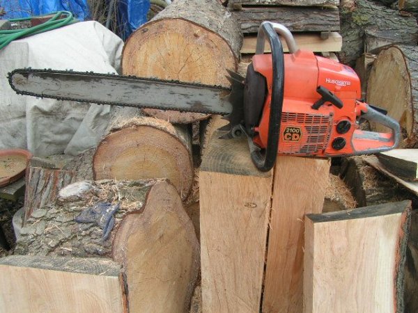

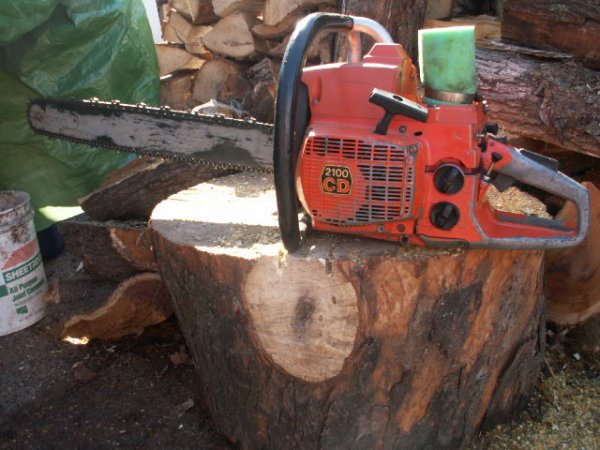

    2100 has a fat magnesium handle assembly ... oil/fuel caps are right nest to each other ... manual oiler button is right there in plain sight ... just to name a few features ..

    The 2100/2101 has the manual oiler also,the 298 automatic oiler only. All 3 saws are same displacement.They didn't start putting chain brakes on them til 1984 or so.My 1983 2100CD has the original clutch cover,with no holes or space for a chain break.

    Ok the bore ruffly measures 54mm!

    288XP is 54mm,281XP is 52mm,298/2100/2101 is 56mm.
