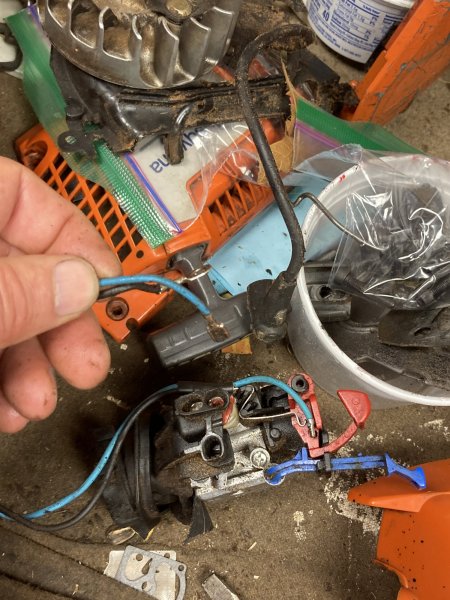

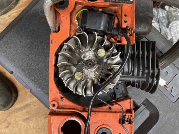

    Mag case on this 51, almost the same as a 55. It’s a two wire coil and grabs the ground to the case at the coil. Contact at the handle completes path to ground at the same mag case
    Here’s a 350 where the on off is surrounded by plastic. The black ground is run from the coil, where it grabs ground and is available to short circuit with the blue via that piece of bent metal.
    Jeff, more than welcome to that 51 coil to try. PM me if you want to give it a shot
