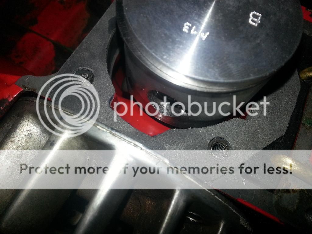

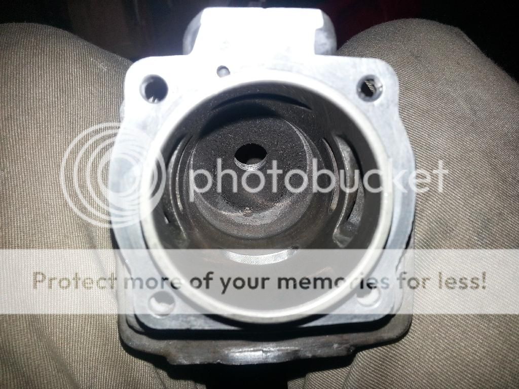

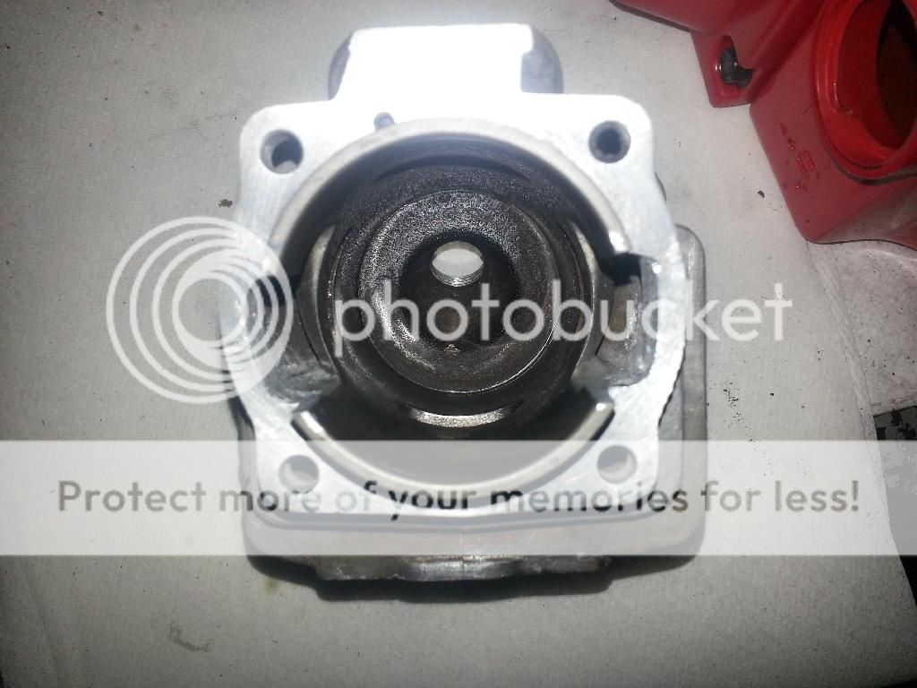

I was able to pick up an almost mint 1998 55 with a scored piston. The cylinder looks like it can be saved. I have searched around for a 45mm piston and was surprised to find out they are unavailable. There was some talk on AS about possibly substituting an Jonsered piston but most of the threads died out a while ago. Does anyone know of a source or substitute for this piston? Thanks!
You can use a piston out of a open port 45mm husky, like a husky 51. There are two ways to make it work. I have some pictures but can't post them at the moment.
Thanks bro.... Looks like it is way above my skill level yet but I may give it a try. How else you gonna learn?
