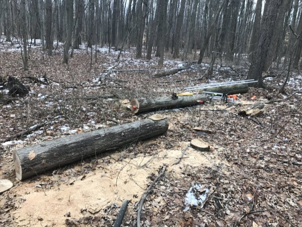

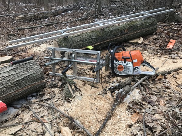

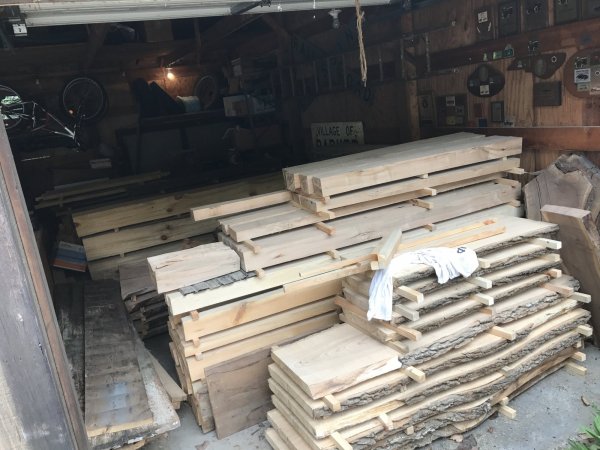

    I've never had a hot start issue with mine. It's probably my easiest starting saw. I do let it idle for a min or 2 after completing a milling cut to allow the saw to cool down.
    I'm no "saw expert", but I know a thing or two about chainsaw milling it's proven itself to me as a milling saw. Oiling ability doesn't matter much if you cut your bar oil with diesel or ATF.
    I don't have any decent pics of my entire stash at the moment but I've probably been thru a couple thousand BF.

    That log that's set up in the pic here. How long would it take to make a cut through thag log? And is that maple?

    Yes red maple. That log was about 6' long, and the cut was about 15" wide. I milled that tree Jan 2 of this year, so my memory of it may not be fresh. I think I did a real good job on my chain that day. I'd say it probably took about 2 mins, maybe a little less. The other 2 logs were 8' and halved down the middle as well, on a single tank of gas.
    I like to cut them in half first and then make my slabs; that way I get most of the mill thickness adjustments out of the way in the beginning and just slab away.

    looks like your 661 is modded....how much milling you do?
