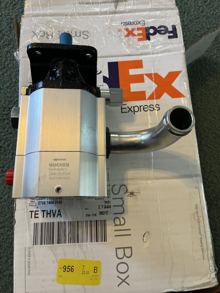

    Coincidence, I think not. My new splitter pump just arrived.
    :smoke:
  2. The Wood Wolverine
    17,272
    108,431
    One step closer;
    I’ll need to get new hose.
    Couldn’t easily break the lock nut free. Moved it a small amount back and forth. Felt like it was going to ruin my day so I stopped. Guess I’ll just loop the hose.

    Looks like a smaller version of what came on my 40 ton CountyLine.

  5. brenndatomu
    22,387
    142,172
    I didn't think about this being an older Huskee...the older ones had the filter on the suction hose...you'll wanna move that to the return line, otherwise its highly likely you'll be cavitating the pump...Huskee (along with most others) did switch to return side filters later on...its the same filter housing, just find the "in" and "out" marks on the housing so that you get it hooked up right.
    You might consider making a bypass hole like isaaccarlson did on his filter...that way you can't blow your filter up when the oil is cold/thick.
  6. JRHAWK9
    JRHAWK9
    Jan 18, 2018
    715
    3,682
    Wisconsin
    damm, why did they do THAT?

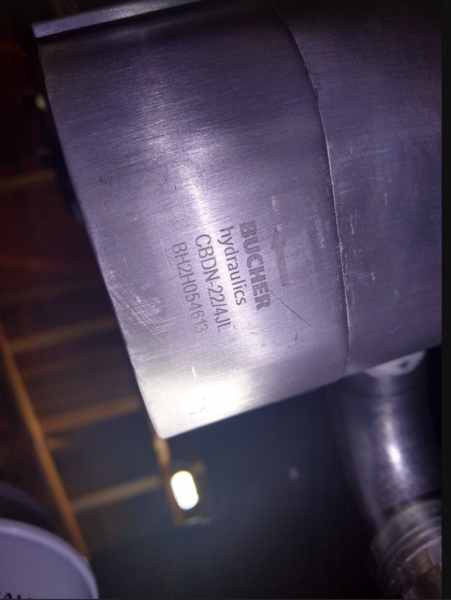

    What's the spec on that one?

  9. brenndatomu
    22,387
    142,172
    It's in the part number there...16.5 on the high side, 3.6 on the low flow side, for a theoretical total of 20.1 GPM...but they don't rate them quite that high as they are not 100% efficient...there is some internal leakage/bypassing...IIRC, that one is rated for 19, or 19.5 gpm?

  11. The Wood Wolverine
    17,272
    108,431
    Guess not so happy valentines day.. :(.
    I don't have the means to machine parts. And I think the return inlet is just a thin post. :headbang:
    So just moving the filter would resolve the issue? Not sure how I can pull that off.
    This pump only has a 90 day warranty so I was hoping to stress it soon. Guess that's out.
  12. brenndatomu
    22,387
    142,172
    If yours is like mine (and all the older Huskees that I've seen) the return hose is just clamped onto a pipe nipple...so you should be able to adapt the filter right up to that, no problem.
    On mine, since I added an auxilary tank, I have the return line/filter on that, then the aux tank just overflows into the main tank via the factory return nipple.
    And again, if yours is like mine, you'll need a 3/4" mnpt to 1" hose barb fitting to connect the hose to the suction port of the tank...like this.
    Groco Full Flow Pipe-To-Hose Barb Adapter w/NPT Thread 3/4" x 1" Hose Barb FF750 | eBay
    or
    1" HOSE BARB X 3/4 MALE NPT Brass Pipe Fitting NPT Thread Gas Fuel Water Air | eBay
    Horkn, eatonpcat, metalcuttr and 4 others like this.
  13. The Wood Wolverine
    17,272
    108,431
    I’m on it like flies on stink, thanks. I’ll post up progress.
