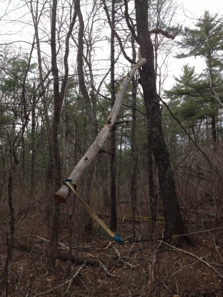

    got home early so I went out back and cut down two red oaks. Hung this one up good.

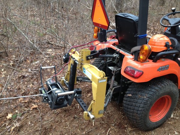

    Cut it as much as I dare then hooked up the tractor and winch.

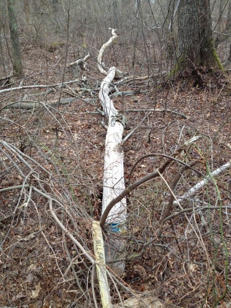

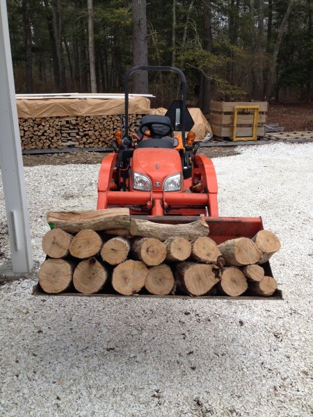

    A few minutes later on the ground bucked and on its way to the stacks.
    Alls well that ends (well) as firewood.

    Nice stacks,gb!

    I think you were just looking for an excuse to use that SAWEET winch set up! Nice work!:yes:

    That :tractor: sure has a mouthful.:thumbs::)

    Nice job, safe and sound, on the ground :saw::tree:

    gboutdoors mind if I ask about the winch? Brand and lengths of pulls, speed? I'm looking to get something similar to yours just on the lower dollar side of the spectrum.

    Standing dead to hanging dead to firewood, good stuff

    It's a TSC Traveler winch made for ATV/UTV low amp draw 4500# pull with a 50' Harbor Fieght 3500# rope in place of the wire cable. Also have a second 50' HF rope that I attach to it for longer reaches in the brush. Don't know the speed but it works Great. I looked at many brands and sizes but this one was the best for low amp draw. It picked the back of the tractor off the ground for a second while trying to get this tree down.
    Ps. I bought this one on sale for $139.00 and the hitch bracket was $69.00 I think.

    HF strap too ?
    Looks like the one I have

    The winch setup is nice. I think I like it.
