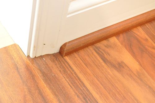

    What is shoe mold?
  6. Jack Straw
    Jack Straw
    8,396
    52,391
    30 miles west of Albany Ny
    Woodwidow shoe molding is the brown piece of wood nailed to the white molding in that picture. Floating floors are sometimes added to old homes and shoe molding is installed to cover the seem between the old molding. It allows you to use the old molding without removing it. In that picture they should have use white shoe molding, it would look better.

    Jack Straw .. the floating floors need to float expand and contract with the weather.
    In my opinion it would look better if you just removed the molding.. Put in floor and reinstalled the white molding and left the shoe molding out of it.
    But to be clear, I am a hack that listened to a couple Craftsman.. ironpony IS a craftsman.

    Thanks for the answer Jack Straw I agree that it should have been white molding then it would have disappeared into the wall.

    Totally agree. I always trim door jambs and casings, and remove and reinstall baseboards so that shoe molding isn't needed.

    I guess I am the odd man out here...I like shoe molding (if its done properly)

    God that's awful, worst is cheap quarter round.
    And this PVC crap for a toe kick under cabinets:
    I've pulled a lot of base molding off carefully if it was old wood worth saving and putting back just because I despise those moldings, even with linoleum.
