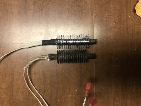

  10. D-Mac0211
    D-Mac0211
    Dec 7, 2014
    360
    854
    Upstate, ny
    Wonder if this could be part of problem. The top is a new Harman oem igniter and the bottom is a used kwik fire that I had when I bought the one that’s in there now.
  11. badbob
    badbob
    Apr 23, 2014
    2,482
    9,946
    I will bring this up,again,some heating elements have more than one element inside them.You can lose part of the elements,still work,but not well.Only way to check is look for almost the whole element getting red hot(80%).To my understanding,Harman elements are still only one element,they work or do not.But,I could be wrong

  12. imacman
    imacman
    Oct 23, 2013
    6,580
    27,281
    Denver, NC
    As LW mentioned above, put an ohmmeter on it....if you get 40-50 ohms, should be good to go. Only diff. I see in the 2 ignitors is the spacing of the "fins". If it were me, and the old one tests good, I'd gently wire brush in between the plates & keep as a emergency spare.
  13. D-Mac0211
    D-Mac0211
    Dec 7, 2014
    360
    854
    Upstate, ny
    That’s what I plan on doing. The Harman has more space in between the fins and it seems to be longer. If it’s longer then it will cover more of the burn pot and light more evenly I would think.

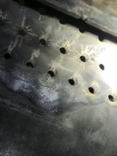

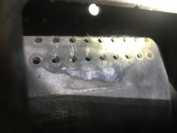

  14. D-Mac0211
    D-Mac0211
    Dec 7, 2014
    360
    854
    Upstate, ny
    I also noticed this today while I was changing the igniter. Looks like it’s cracked between some of the holes.

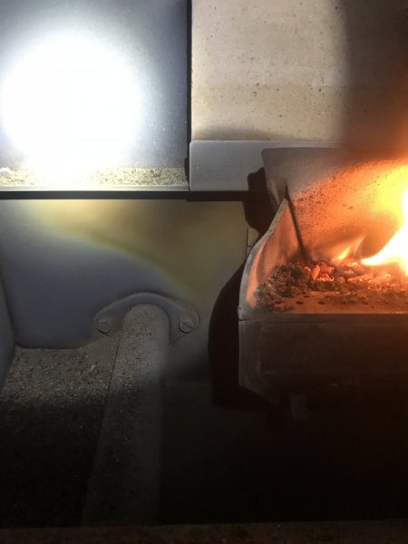

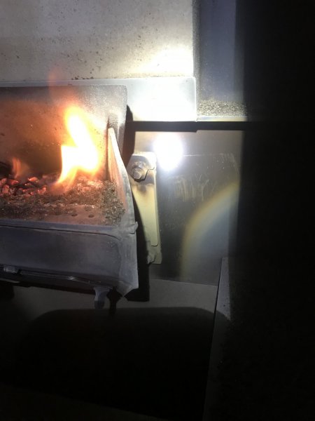

  18. D-Mac0211
    D-Mac0211
    Dec 7, 2014
    360
    854
    Upstate, ny
    I think I might actually have a bad burn pot or burn pot gasket. I don’t know why else I would’ve getting that kind of weird burn pattern on the back wall of the stove. Maybe the flame tamer isn’t sitting right but I made sure today when I put the igniter in that it sat good
  19. imacman
    imacman
    Oct 23, 2013
    6,580
    27,281
    Denver, NC
    Is that a "normal" flame for that stove? I can't see it completely, but it looks lazy. Can you post a video?

  20. D-Mac0211
    D-Mac0211
    Dec 7, 2014
    360
    854
    Upstate, ny
    I had the door open to take the best pic. It’s in cooldown mode right now
