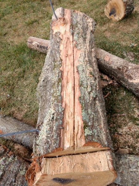

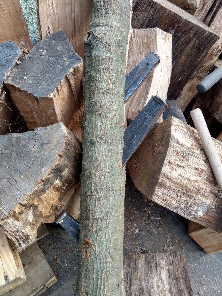

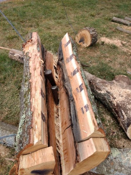

    Skinny log, just keep leapfrogging your wedges down the length. IMG_20170901_173221599_HDR.jpg Fat log... IMG_20190910_0631.jpg IMG_20190910_10941.jpg IMG_20190910_52910.jpg This work really well on skinny or fat red oak.
