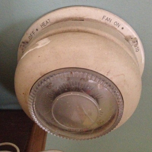

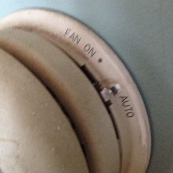

    I have a forced air furnace with ac coil on it. In the winter I run the blower and it evens out the house temp. This is a pic of my tstat. Old school I know but left lever switched between heat and ac, right lever turns on blower manually.

    I think what he is talking about is just an A/C unit? It's not the same system for heat? So there is no "On" or
    "Auto" setting. When it's "On" it's gonna blow cold air from the condenser?
    And I agree with Lukem and Smoke. Most pellet users that have tried this find it does take heat from the room the stove is in, but the rest of the house feels no difference. To much heat loss in the HVAC system.
