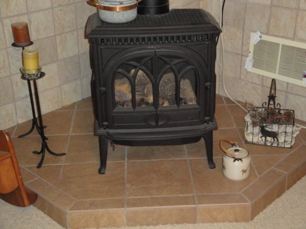

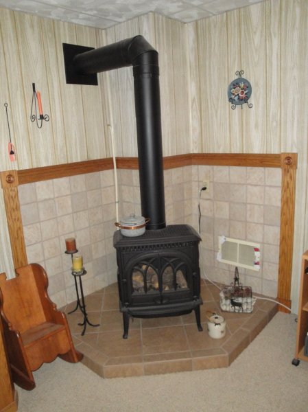

    I have a jotul gas unit in my basement. Warms it up nice when we need it. DSC01523.JPG DSC01524.JPG
    milleo, LongShot, fishingpol and 10 others like this.
