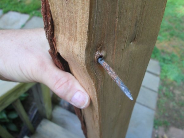

    I thought maybe it was from hitting trash in the wood...it happens...

    i hit a nail in a red maple split not too long ago. Hitting metal with the ax surprises me more than with the saw. I find metal in splits, but its very rare that i hit it the way i did. IMG_0598.JPG
