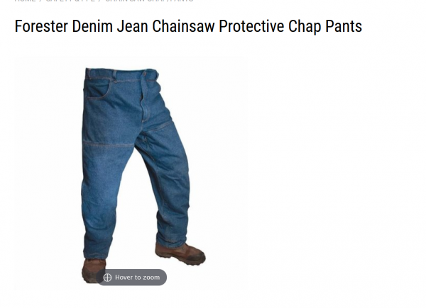

    Sidenote... the fellow says he has inside chaps on. Underneath his jeans? Never heard of that, that's interesting. Seems that would be hot! And uncomfortable.

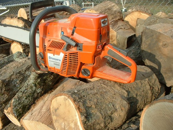

    He should have showed the technique in a much larger log. But he is correct, always cut so the dirt is being thrown away from the power head. I cut cable skidded logs most of the time, dirty is just the price of admission.
    The only thing I would add is 404 semi chisel chain on a hard nosed bar does last about 3x longer than 3/8ths chisel before it needs to be touched up. When the cut is started at 2 O Clock on the log, bore cut almost all the way through, continue to the bottom of the log and then push the tip out of the log and cut up. The uncut part on the top of the log also stops the bar from getting pinched.

    I think what he means is the chap protection material is inside the jeans. Like these:
    I'm not necessarily promoting these, I just really want to try a pair.

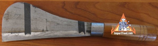

    Hatchet, meat cleaver, or my favorite a straight edged Thai cooking cleaver. 171A5A36-0863-4DE7-B233-9C906C332661.jpeg
