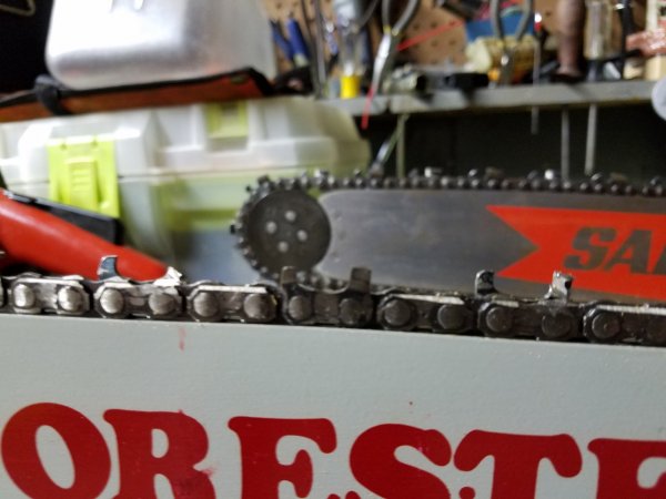

    I have quite a few older chains, say 10 to 15 years old. As I was sharpening some today I noticed a few were getting a bit of slack in the links. I have enough to keep swapping out so each one only gets sharpened 2 or 3 times a year. They still have quite a bit of tooth left.

    Well when the cutters are little bitty triangles, they are shot.

    If rivets are loose I would scrap the chain. I would not want any busted chains flying off.

    I run mine until they have little bibits of triangles left of the top plate. I have done so for decades and thousands of trees.
    Generally when a couple teeth break off the chain is junk. Look at a race chain sometime and you will see just how far a chain can be pushed!

    Well Travis, my rivets are all slack but I'm getting pretty short in the tooth department so I guess I aint gonna get no sharper.:D Did you find a home for that calf?
