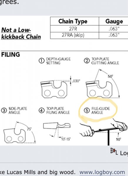

    I’m not even sure if my chains call for it, but I never attempt it. How important is it?

    I prefer it, but it's not a must for a good cutting chain.

    I have to angle it some to hit the point of the top plate and side plate.
