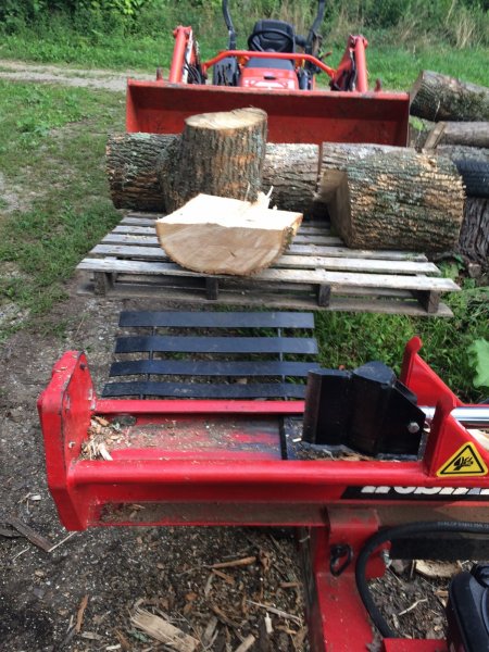

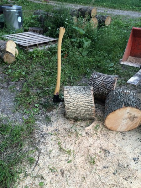

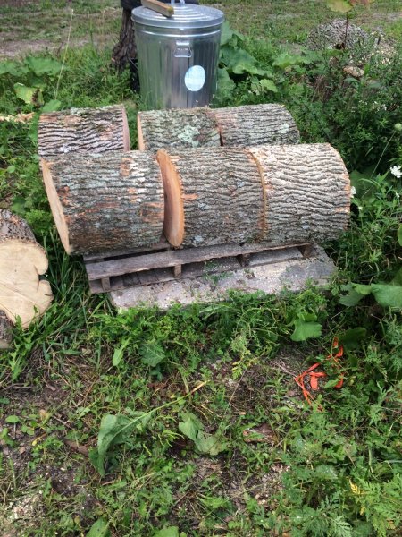

    A couple years ago, I decided I had to come up with a less labor intensive way of processing my firewood. Basically, I needed a method where I didn't have to bend over as often and lift as much. Here are some pictures from this evening that show how I've been processing the wood this year.
    My Kubota B7610 plays an integral role in all aspects.

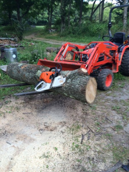

    Holding the log as I block it:
    Using the picaroon to move the blocks to a pallet:

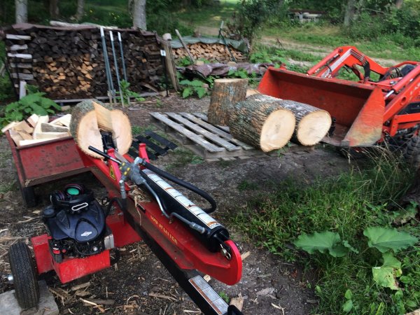

    Blocks on the pallet ready to be lifted and driven to the splitter;
    Rolling them off the pallet onto the splitter;

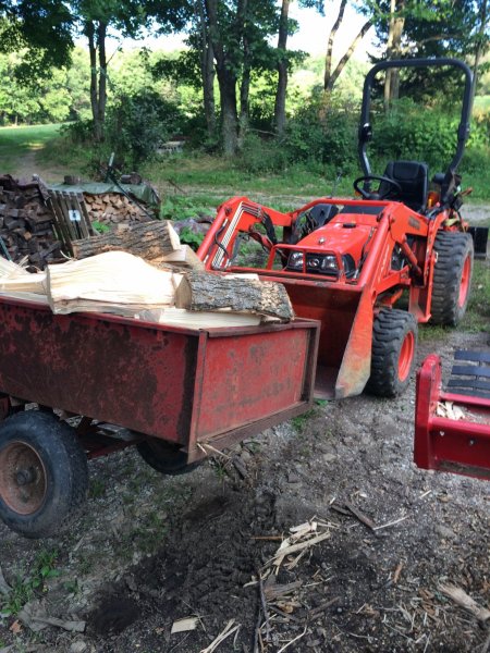

    Taking the trailer loaded with splits to be stacked.

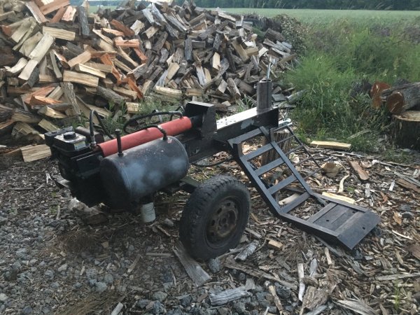

    I like the process seems like it would save your back. My splitter is only horizontal so I made a log lift that has saved my life. The lift also doubles as a table once the rounds split and try to fall image.jpeg

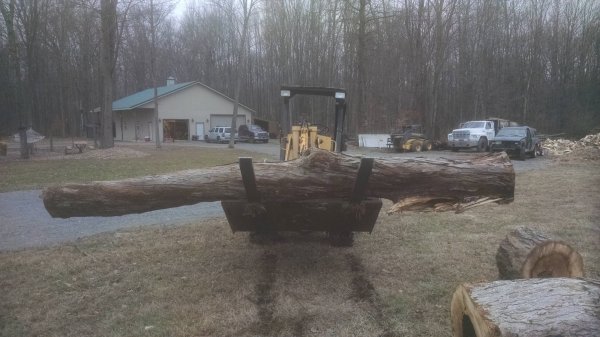

    I use two sticks of c channel that chain and binder around my loader bucket. They can take some serious abuse! image.jpeg

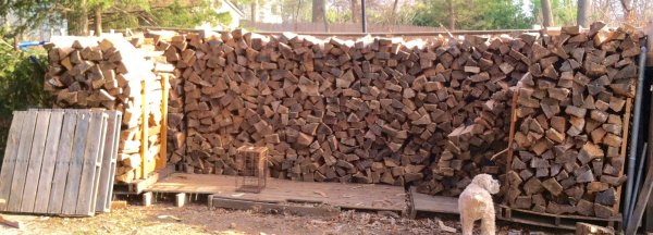

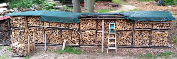

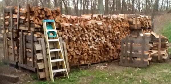

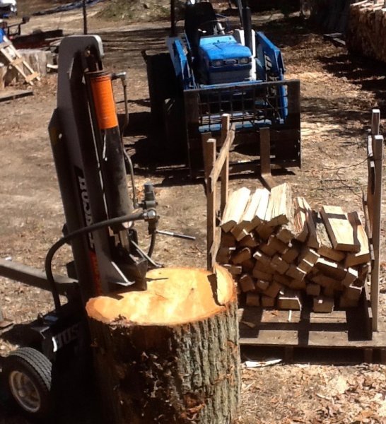

  17. mikeward
    mikeward
    603
    4,042
    Long Island, New York
    Love what you are doing @drascro

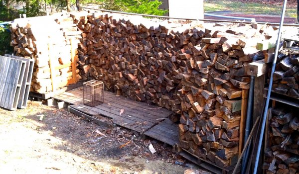

    Having a tractor with forks is like having a work crew helping you.
    I split all my small stuff like you do but instead of throwing splits on trailer I put them on a pallet that I can move with the forks. You might want to tinker with that idea. Could make you handle wood less!
    In The pic I'm splitting vertical but putting right on pallet. You could do the same thing while splitting vertical.
  18. Dascro
    Dascro
    Dec 2, 2014
    195
    1,002
    Southwest PA
    I'll have to give your log tongs a try Dennis.
    mikeward, I think your pallet idea makes a lot of sense and may be a keeper for me. Good idea!!
  19. mikeward
    mikeward
    603
    4,042
    Dascro
    I've got aroun 50 cords of wood stacked up here and there's no way I could have it all on pallet racks.
    I've got 71 pallet racks full, its around 23 cords of wood the rest is stacked as described below.
    I make some pallet racks and use them as bookends for a stack 10 to 20 ft apart. Then I use 2 pallet racks as carriers to go back and forth from the splitter and unload them between the bookend racks. The advantage over lifting your small trailer is no sides to lift wood over. I can lift pallet up to match height if stack and quickly slide splits onto the stack. Goes quickly then I take the 2empty pallet racks back to splitter and repeat.
    In the pics you see 2 pallet racks on top of each other for bookends. I make the top one 2 1/2 ft tall. That makes the finished bookend around 6ft tall. In the last pic you can see the 2 pallets i'm using to transport splits for stacking
    I love using my tractor to move firewood. I can just lift one pallet of wet red oak a food off the ground. After drying for 3 or 4 years it's much lighter and I can lift it full height of forks.
