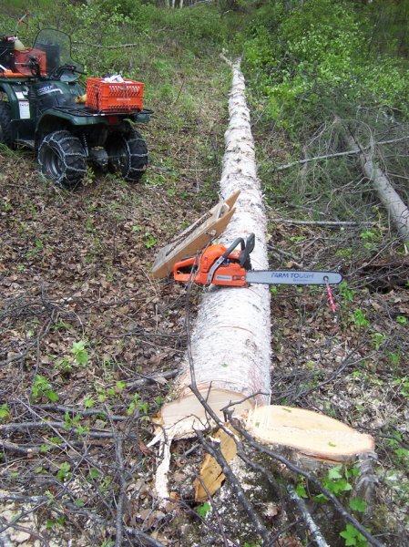

  1. bogydave

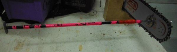

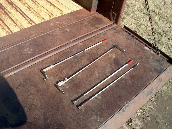

    I use a piece of an old graphite fishing pole
    Glued a 1/4 - 20 headless bolt in one end & attached it to the bar with a wing nut.
    Have a 17" one for my stove (+ a 16 " in case I cut for someone else).

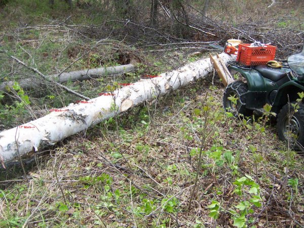

    Mark the log before I cut it to sizes I can skid out to the truck/trailer
    Uniform length & no short rounds of the end of logs.
    If I can get the log off the ground, I just leave it on & cut 15" & smaller rounds.:

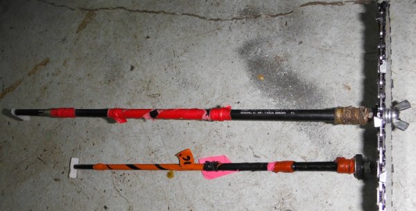

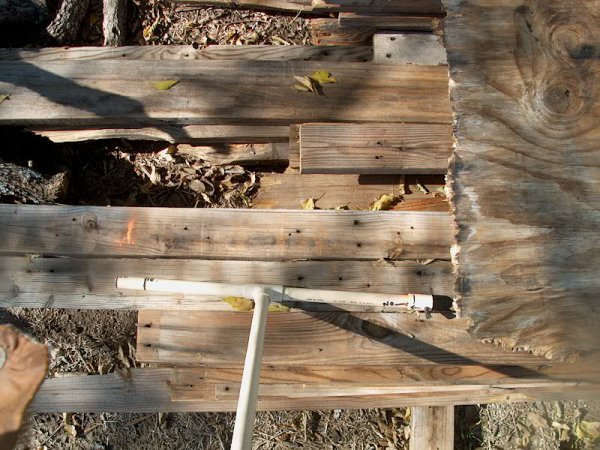

    I made a pvc tap-a-log that uses carpenters chalk.
    I made 4 different fishing rod markers.
    2 with hard drive magnets and 2 that are spring mounted to bar nuts.
    The one that works best for me and is the fastest to use is the spring mounted ones.

    Sweet !
    My next one will have the antenna spring :)

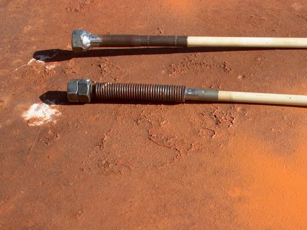

  9. HDRock
    17,252
    60,393

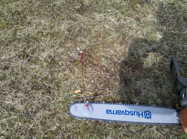

    Here is my whip antenna , it has a set screw for adjustable length , I cut to17"
    Started out with a wing nut ,then changed it to a magnet
    Saw Marker.jpg IMG_20130414_151943.jpg IMG_20130414_152010.jpg IMG_20130414_152128.jpg
  10. bogydave
    Spring & magnet are upgrades.:thumbs:
    New model I copy the ideas.
    Drvn4wood, Ralphie Boy and raybonz like this.

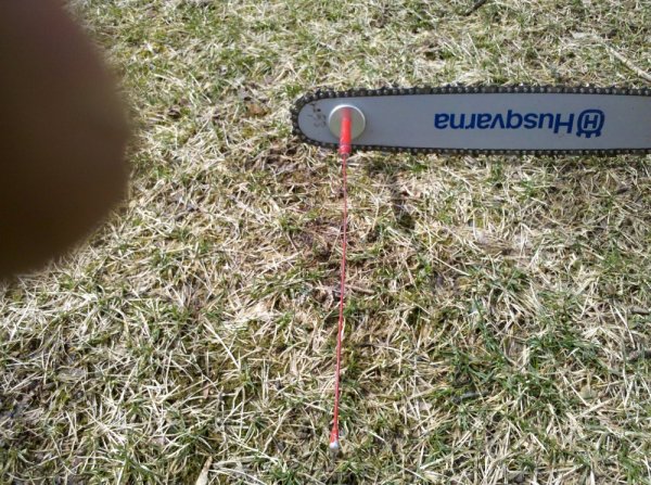

  12. bogydave
    New one with strong magnets.
    [​IMG][​IMG][​IMG][​IMG]

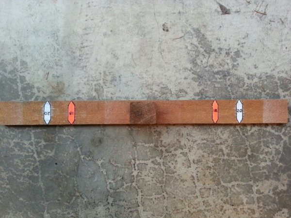

    I'm surprised you all are talking about a single cut length for measuring and marking?? I buck at either 18" or 20". For the 18", I have a 6' long 1 x 2 piece of wood I painted bright orange, and I marked it at 18", 36", 54" and the other end is 72" with a big bold black line. I simply lay the piece of wood on the tree, and mark the tree with a piece of chalk at each mark (4 marks). I can then slide it down to the last mark and repeat, takes 20 seconds to mark a 30' tree. Now you can cut the entire tree without measuring or marking anything, just cut on the chalk marks....

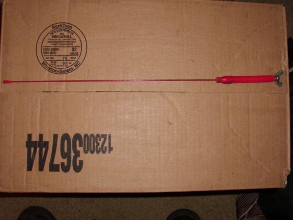

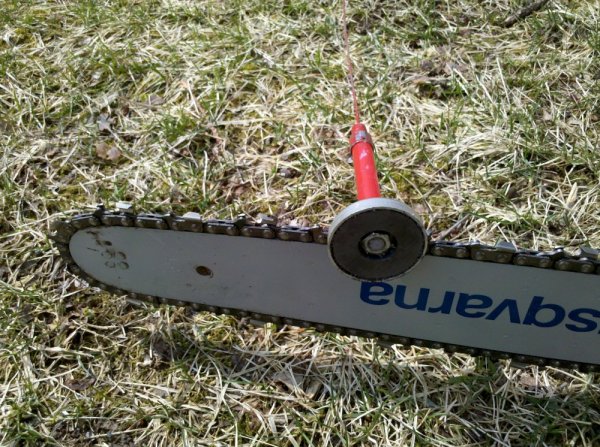

  18. bogydave
    I've used several methods to measure
    This one works best for me. strong earth magnet.
    1 tool, easy, fast, accurate , small to carry in/to the woods, fits in my pocket
    Walk the log & mark, pull it off & start cutting
    WinonaRail, NYCountry, HDRock and 2 others like this.
