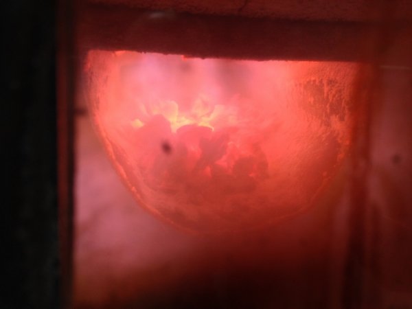

    my boiler gets to 2200* and everything in the secondary chamber glows red. :p
