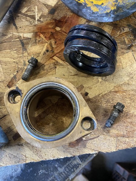

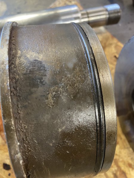

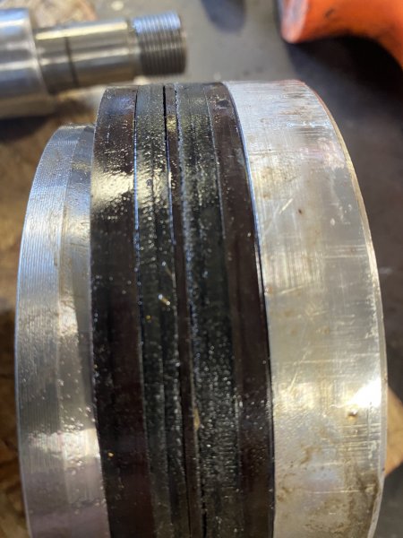

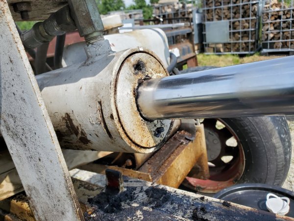

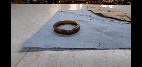

    Leaky seal on my used "gas station" bought push through splitter.
    I assumed the spanner holes, that someone destroyed, would loosen the end cap but after looking on line, found they are only to rotate and allow the square wire to be removed or installed through the grove in the side.

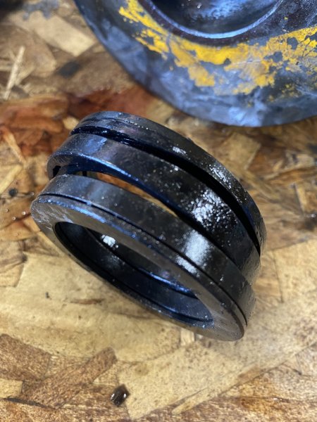

    Found the culprit:
    This place is a God send!
    They know what they are doing and got me fixed up the parts needed to get the thing repaired.
    They even got me the 3 foot of 1-3/4" chrome piston rod I needed to fix my oops moment in galling the existing rod. I'll turn and single point threads on tomorrow.

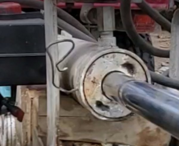

    I see the old wire in the hole trick on that one.
    Years ago I was in the refuse / truck repair type job. Spent most of my time on the road repairing industrial/commercial compactors ; when not on the road I was in the shop installing and repairing trucks , again mostly refuse trucks but also dump trucks and such.
    You don't want to even know what it is like to crawl through the access door on the body trash truck to repair a push out cylinder on a truck full of trash that has been sitting outside for a few days in the heat of summer. The living rice crawling around in there was beyond belief.
    Have done a few of each over the years. Wire in the hole , internally threaded , Externally threaded cap , some had a brass packing nut on the rod end you could tighten that sealed around the rod , and the multi stage telescoping that was 5 or 6 cylinders built into one.

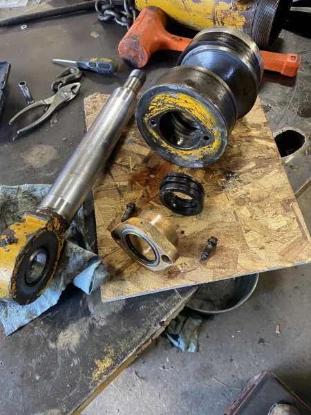

    I’m expecting parts tomorrow for this wheel lean cylinder off an old gallion motor grader
    05DC609C-2AEC-4EC0-AF55-3767AB0F7109.jpeg 95F8850C-D117-44A6-BDB2-F047EA016CDD.jpeg C14400EF-C63D-45C9-AE38-3F6F4A965EE3.jpeg 3B0CCF3E-517B-49B2-8602-32A75004F872.jpeg 9557DC77-5590-4682-B963-AFB16D9664DD.jpeg
    if I can baby it enough to get through the summer I’ll have to do the steering cylinder and one cylinder that lifts the mow board later this winter
