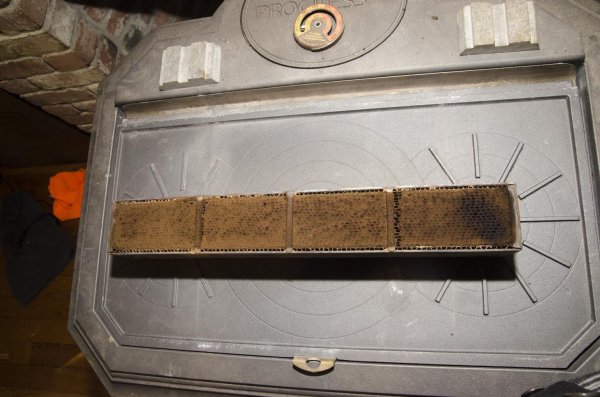

  18. fire_man
    fire_man
    Dec 5, 2013
    282
    689
    North East MA
    This is a cat that maybe should get cleaned :confused::confused:

    Yes.
    I've never seen one quite that dirty.
