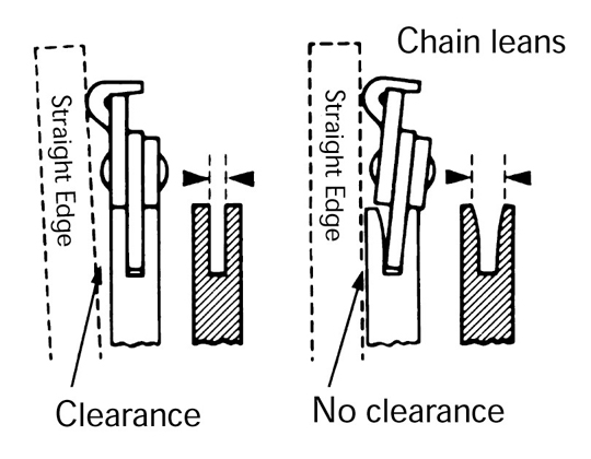

    Seriously though, put a straight edge up against the bar & a cutter, then look for a gap where the cutter holds the straight edge away from the bar (a gap is good).
    Madsens1.com has a good article on that, under ‘Bar & Saw Chain’, then go to ‘Guide Bar Maintenance’.

    I did the straight edge test and it is time for a new bar. Thanks

    That's the best information and illustration I've ever seen on determining bar wear.
