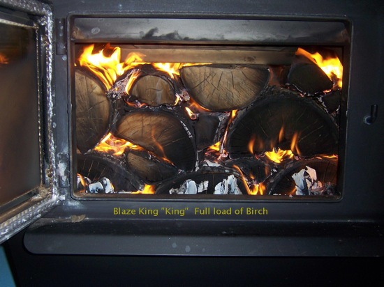

    I keep seeing pictures of stoves jammed crammed full of wood and I have to ask: are they cat stoves? If so, how are you doing that without overheating the catalyst?
    I've done it a few times in the past but I have to keep a close eye on the combustor to prevent it from going off the charts. Both the Buck people and the maker of the catalyst say I'm wasting fuel by using more than 3 or 4 splits. I've had the 80 for 2.5 burning seasons and overheating the combustor is always a worry.
    Am I not letting the fire burn hot enough and creating too much smoke thus "over feeding" the combustor? I seldom have any of the air vents open after the combustor reaches 600 and stays there for a while.
    Also, if the combustor starts to go into the red zone what's the best way to reduce the temp? I generally open the by-pass but I've heard that I should be opening the air vents to get more air into the fire.

    We fill our stove but never jam it in. But we go to the top of the firebox. Then we wait anywhere from 5 to 20 minutes. We want the flue temperature around 450-500 (single wall black) then cut the air and flip the cat on. For our control, it is 0-4. When we turn the draft down it is usually to 1 but sometimes a bit above 1, depending upon the fire. Than after maybe 10 minutes we usually set the draft to just a tad below 1, or at .75. Once we do this, the stove runs itself and we don't need to touch it. But for sure if we turn the draft too low, then the temperature will go berserk.

    The Keystone is small and doesn't hold much wood but I stuff it full. I've never had a problem with the cat overheating. I have a cat probe and with a max temp indicator and I don't think it's ever been above 1375F. I get higher cat temps when I set the draft to zero, the higher I set the draft, the more flames and secondaries I get, and less smoke for the cat to burn. If I needed to cool the cat I would open the bypass or increase the draft.

    My Buck went nuclear on me a couple times last year but I can't remeber what the senario was for sure. Cat was up to 1800-1900. I disengaged the cat for about 1 minute then gave it a little more primary air, it settled in and hung at 1800 which didn't scare me too much as these things are built like a tank. I will sometimes fill pretty full and it depends on cold start with a relativly cool cat or a reload with a fairly warm cat at 600-800 on how I let the wood catch. If I'm loading on a cooler cat 200 or so I will let the wood catch well (both drafts open 1/2) until I climb to 500-600 then shut the drafts for few seconds and engage the cat, then open both drafts to 1/2 - 3/8 until the cat lights. After light off I close the draft that feeds under the fire and close the primary down to about 1/8 (I don't close mine all the way ever). Cat will then climb to about 1400 - 1500 and stove cruises. All those temps are cat probe temps.

    I pack the cat stove full and let the thermostat regulate the stove temp. The temp of the cat is irrelevant. You will worry yourself to death trying to fuel and run your stove to get the output you want while also trying to regulate a cat temperature.
