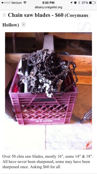

    I bought a milk crate of various chains off of craigslist a month ago. I finally got them cleaned up and sorted out. The guy obliviously ran stihls. I ended up with about 15 3/8 .050 72 dl chains which I can use because I have 2 bars that run them.

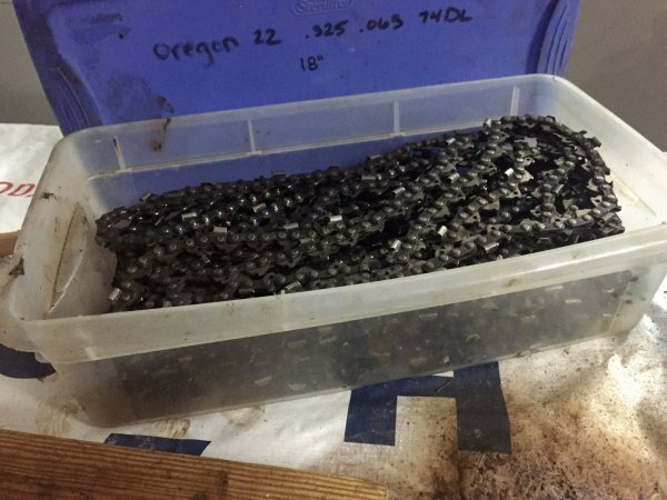

    I also got 35 .325 .063 74dl chains that are dull but never sharpened. And 10 .325 .063 67dl chains in good condition.
    I have 3 saws that run .325 but are all husky small mount, ko95. I haven't found a single husky small bar that is 74 dl .063. I looked for adapters to run a Stihl bar but don't see any for small mount.
    Can I use these chains with these saws?

    Stihl .325 063 18" is 74dl. Husqvarna uses 72dl for an 18" in .325 however they are .050 in gauge.
    You can contact Homelite410 about an adaptor for 12.1mm to 8.2mm, but you will have to lengthen the stud slot on a Stihl bar to accomodate the adaptor. The stud slot on a Husqvarna bar is about 1/2-3/4" longer.
    I have a WoodlandPRO breaker/spinner set that I bought on sale for $129.
    You may be better off just cleaning up the 67 and 74dl loops of 325 063, and selling them off, as every other option will require more of a cash outlay.

    There was a lot of chain in there. 73 total but I tossed 8. There is a bunch of 3/8 low pro chains as well. I hope I will be able to use them all!!!:saw:

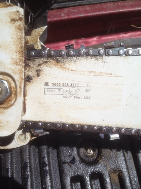

    My Stihl MS250 18" takes .325 / 68DL / .63.

    We were talking 3003/D025..........3005 mount isn't really 18" either.

    Jonathan, does that mean the MS250 is a large mount bar?
    clemsonfor likes this.
  14. Jon1270
    Jon1270
    1,886
    4,543
    Pittsburgh, PA
    No, 3005 is the smallest Stihl mount pattern. The way these sizes are named in casual conversation (small, large, etc) tends to get confusing. For Stihl, 3005 fits the smallest saws, 3003 covers the vast middle ground (026 through 066), and 3002 covers the uncommonly large modern saws and a few older but only sorta-big models.
