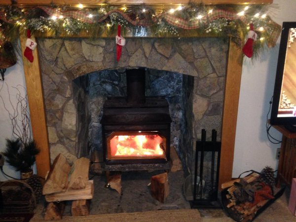

    We have a Country brand stove, and have had great luck with it, but the only work that I have done to it is replacing the blower motor once or twice, more of a pain getting the stove out to work on it than changing the motor, that is pretty straightforward IMG_0809.jpeg
    Some of our brick, mainly the floor of the stove is getting to where it should probably be replaced, but I haven’t been brave enough yet to take it out.
    There are different sizes, and I haven’t figured out yet what, where or how to order them.
    Wish that I could be more help, but I don’t even have an owner’s manual for our stove
