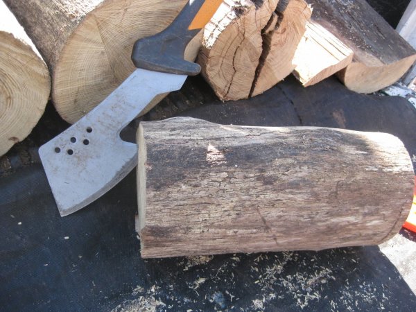

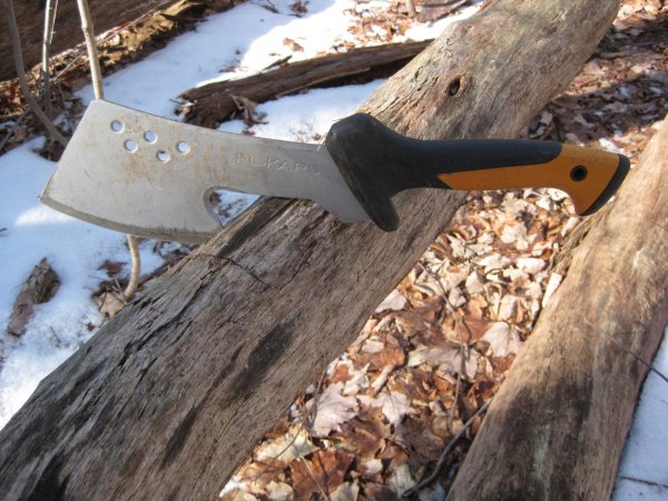

    I never try to take bark off BL when cut green or if bark is tight. Leave rounds/splits to weather a few months and itll loosen. If you must this might work. I use it when bark is loose enough. Fiskars product.
    Note: that is a barkless dead black locust round. IMG_0332.JPG IMG_0331.JPG
