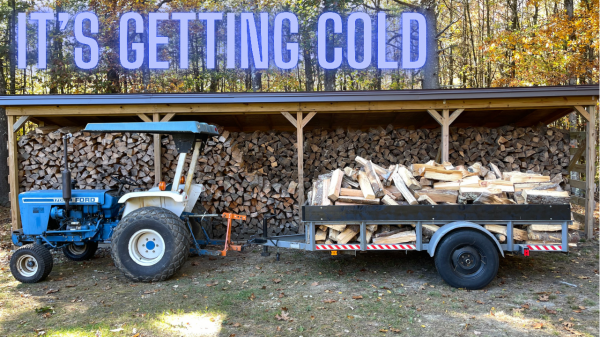

    On a related note, I splurged and bought brown tarps and hooks, and cover my stacks the way this guy does:
