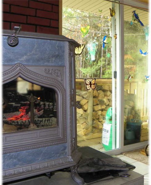

    We don't and won't keep a day's worth of wood in the house. However, on the really cold below zero nights I will usually lay 3 or 4 splits behind the stove and will put those in sometime during the night just to keep the temperature up. I get up anyway, as lots of older men usually have to so it is no problem. But most nights we do not add any extra so no need to bring in extra. However, we can also consider that our wood rack is not too far from the stove anyway.

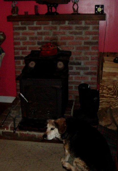

    Although probably not considered to be the optimal in safety, I keep enough for 24 hours burn (roughly 18" from the stove). The way my cellar is set-up does not allow for a convenient way to store wood. So, I have to store outside in a covered wood-crib. As part of my daily routine, I bring in enough wood for a day. The heat from the stove removes the frost and/or snow. I tend to stack it with the soft wood/poplar furthest away from the stove and denser wood closer to the stove. 25+ years doing it this way, no problems yet ("Nock-on-wood":)) You can see a little to the right of the old dog in the photo.

    Ok I have to ask is that stove an all nighter and us the dog half a beagle?
