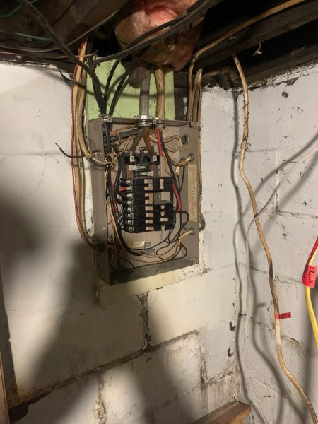

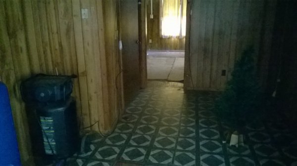

    Finally making some progress on this house from 1903. - not my primary residence
    Figured I'd share the journey, tried to keep most of them in order but not doing too great at that.

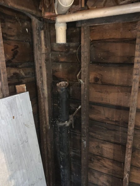

    Reworking the main drain because they had the wye sticking really far out, so I'm reclocking it.

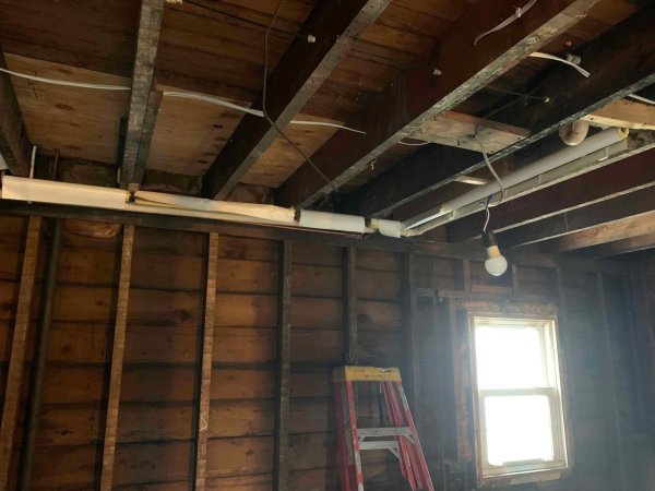

    Also just showing insulation installed on the copper pipes.

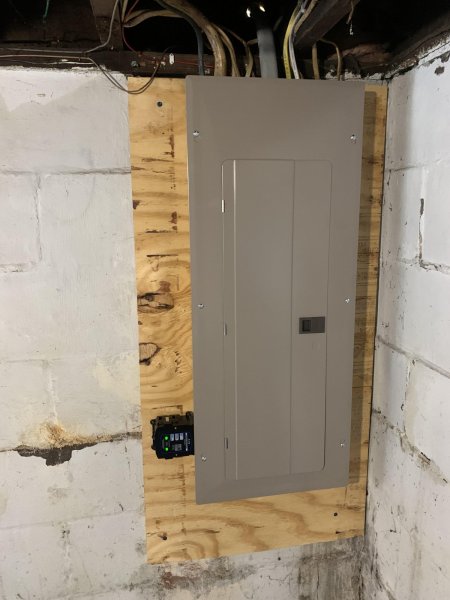

    Panel looks low on breakers because it is. Still installing new circuits, adding wiring, cleaning up the mess and eliminating knob&tube. Went from a 125 amp panel with 2 sub panels to one 200 amp panel.
    box on lower left is a surge protector for the house.
