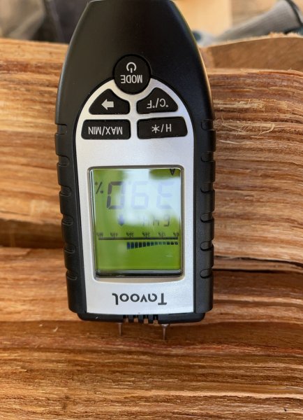

    This wood was a standing dead HL, fell and sat for 3/4 of a year before I blocked it up. Split some today after bringing it home Nov last year. This represents the middle ground of 3 readings. Very curious to see how long it will take to get to 20%. Seems like it’s holding on pretty good.
    Sorry for the glare
