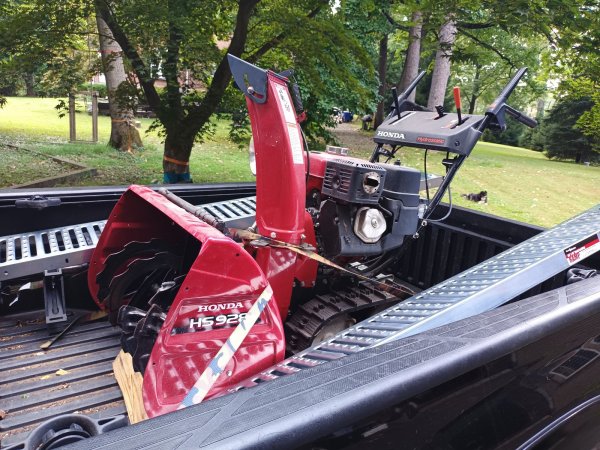

    Yes sir! I bought a set of 10" straight steel ramps from HarborFreight in order to transport this in my Tacoma. Those worked perfectly for this application. Used two 1" ratcheting straps to secure the ramps to the tow hitch. First time doing that ever.

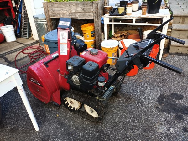

    Tried starting it and it started then died quickly. I suspected lousy fuel so I sat there with a turkey baster and took my time and got rid of the old gas. As you can see it was nasty. Put some fresh fuel in and she started right up!!
    Haven't had time to look at it further other than notice a) the headlamp works fine and b) the lever for the chute control (up and down) does not do anything. May have to replace the wire but I will see.
    9 HP, 28" width, track drive. This thing will be a beast! And just in the nick of time.
    Anyone else have one of these? I am not sure how old it is but it doesn't look like it was used too often.
    I will do an oil change and perhaps a hydraulic fluid change.

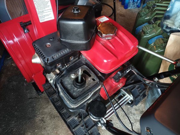

    There's an air filter housing on this snowblower so I was like "Ok let's pop that open and see what the filter looks like...."
    Well I done learned something new today......And I guess it makes sense that when using a snowblower there really isn't going to be too much dust flying around and maybe it will attract moisture and freeze more than it would filter out dust. And it also makes sense that they use this same engine on other machinery (log splitter, wood chipper, who knows) that is used during the warmer months and then they would include an air filter.

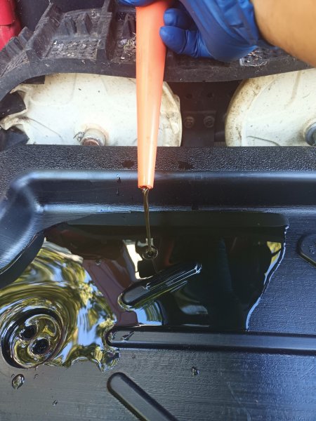

    Changed the oil. It looked pretty watery and thin.

    Will also drain the hydrostatic fluid and replace.

    Thanks all. I'm pretty darn stoked. Just waiting for the wire to arrive. Given how nasty the tranny fluid was I'm thinking I should have taken the opportunity to drain the auger gear box while I had it all apart and now I don't feel like taking it all apart again and I also don't feel like tilting the machine over just to drain that thing. P:erhaps it's time to invest in an oil extractor pump.
