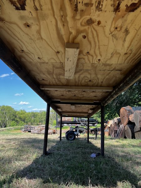

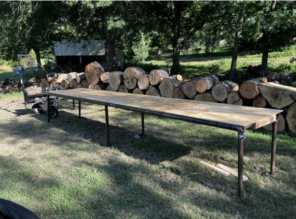

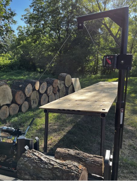

    Took an old pallet rack and flipped it upside down, cut a couple feet off and decked it with 3/4” plywood. Have the splitter set up at one end and it slopes slightly that way. I will set rounds up in the table with the tractor and use the the splitter winch to bring them to the splitter. Put some 2x4’s under to keep everything in place and sure it up a bit and slapped some Thompsons on it for longevity. Excited to try it but two days on it in this heat- gonna have to wait on splitting….

    I will buck them then set them on the table with tractor grapple. Table is 20’ long so will hold a bunch. I will pull them to the splitter with winch.
    I am going to use the legs I cut off this rack to make a bucking station actually. It will sit close to the table.
    my ultimate goal is to never bend over again. Hahahaha !!

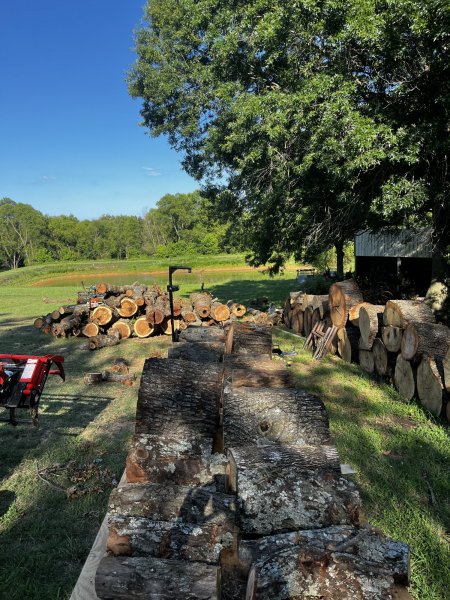

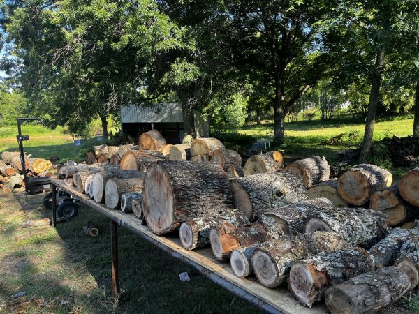

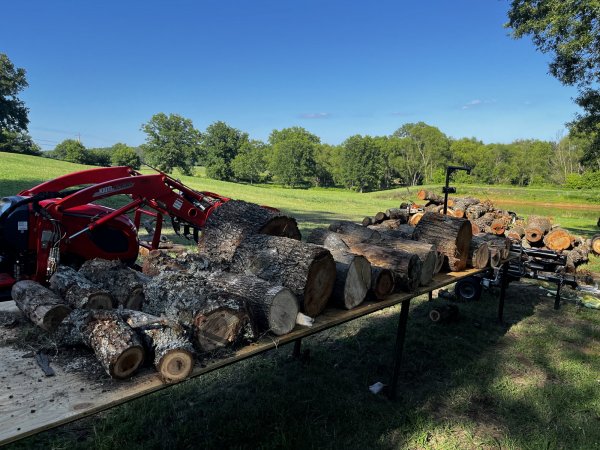

    Got some wood loaded on the table today. I think it is going to work out perfectly 19F21241-9FD9-49F0-BCE9-93C9A6C6CBED.jpeg 39B02FA7-C349-45E2-92A8-25648DECEA4A.jpeg A1D9FAF6-25CB-445A-B4E3-A2911AD09F33.jpeg
