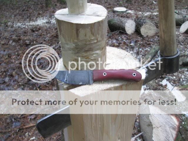

    Here is a homemade froe and maple mallet. Making some spruce shakes for another project. Haven't quite found the right bevel for the froe yet. Anyone have a suggestion?

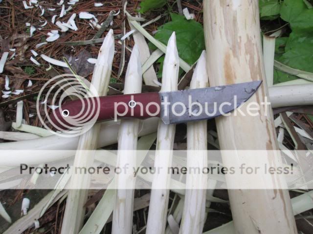

    Her is a pic of the shake in progress. I have some pics of a hay fork made with a knife and brace bit if interested.

    Yes, pics! Do u make your own knives?

    I don't make my own knives, I'm heat treat challenged :) That one is a JK Handmade, superb knives O1 steel at it's finest.

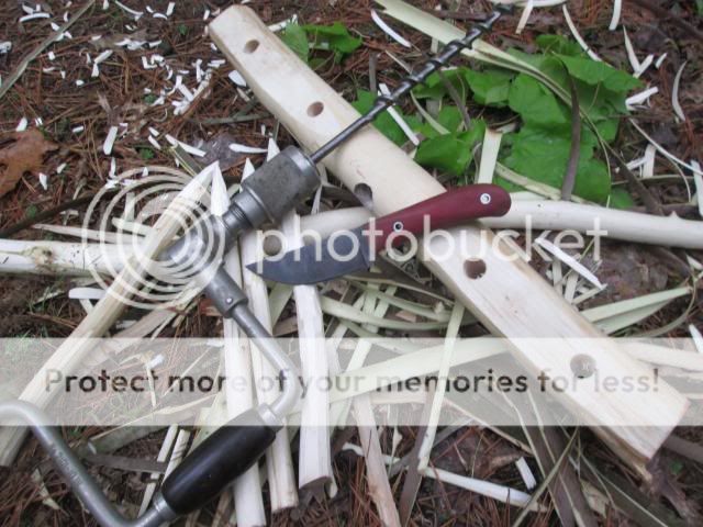

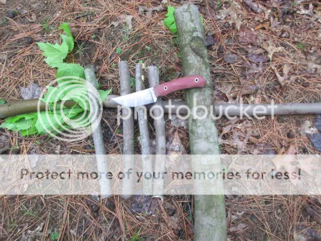

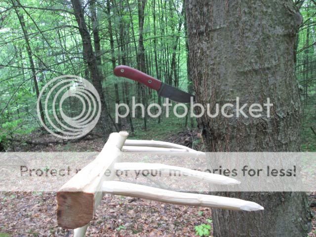

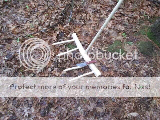

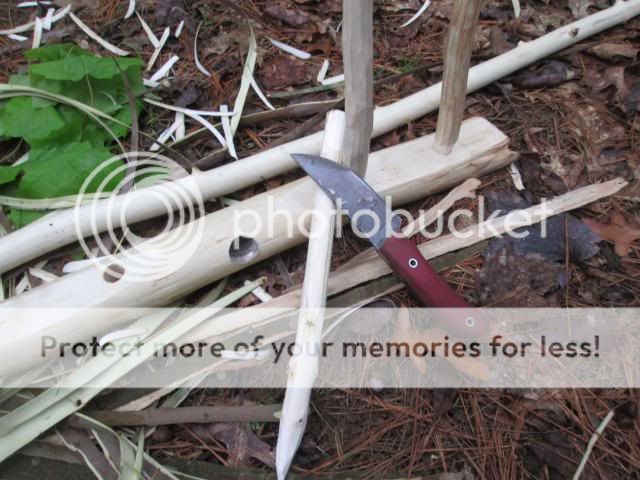

    Here are a few pics of the hay fork.
    Raw materials, a maple sapling:
    A little peeling and trimming:
    Drilled:
    Fitting:
    Done:
