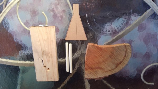

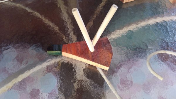

    I was at an estate sale yesterday and found a pile of old electric ceramic rods for cheap and got the idea of homemade crop stick for presents. I had a pile of cherry cookies that I cut last year and thought what a perfect base. The rods are angled at 20 degrees for kitchen and pocket knives. This is my prototype. The darn jig slid a bit. I will clamp with the next set.

    The ceramic is a nice tight fit. I wanted to be able to remove to wash. They load up on metal after time.

    Did you saw a block of wood to set the angle with for the base wood, or do you have a radial drill press?

    On a piece of furring strip I used a protractor and matched the angle that I wanted to the drill bit. 3/16 pilot hole just to get what I wanted. 25/64th was the final size. Drilled both holes the whole way through while clamped to a 2x4 piece. No fancy tools, tried to be creative...
    For the holes in the crock sticks base I just held in place and used the furring strip holes as my guide. I should have clamped also. Slid just a bit on the first hole.

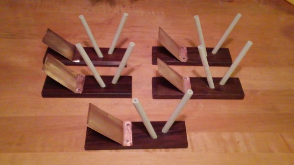

    Just finished these crock sticks for Christmas presents! I changed it up a bit from using the cherry cookie wood. There were a couple pieces of ipe that I was saving for a special project. It found its place. Check out the copper finger guards! KIMG1417.JPG
