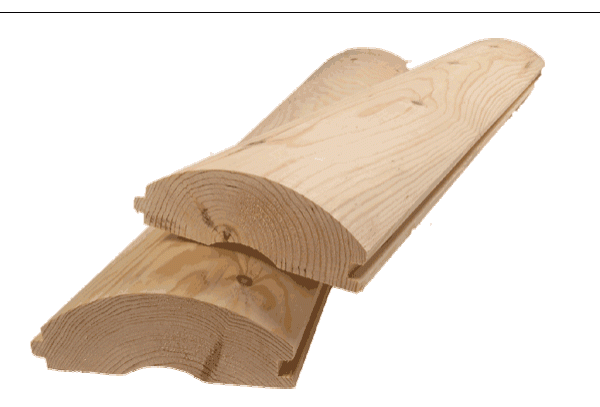

    Mine had NOTHING between the siding and the insulation! No OSB, plywood, foam, or even Tyvek. So it went - siding, insulation (unfaced), drywall.
    This kind of siding:
    Do you think it might have leaked a little air? :hair:
