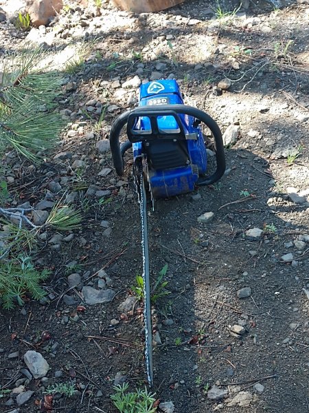

    I have witnessed this "holzforma G660" cut about 4 cords of Doug fir and larch. It belongs to a friend of mine. It starts and cuts wood, but the oiler will barely oil a 28 inch bar( yes it's turned all the way up) and the air filter is garbage. I guess it's like lots of other chinese stuff when it fails you just go buy another one. IMG_20191013_105006223_HDR.jpg IMG_20191013_105006223_HDR.jpg

    The holzforma g660 that my friend has been cutting with is doing alright. He cut 2 more cords with it this weekend. The oiler seems like any longer than 28 would be to much for it, but then again a guy can cut up some darn big trees with a 28 inch bar. I think for intermittent use on a couple of big trees a year these G660 saws are alright.
