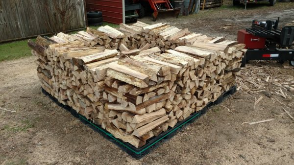

    We did a square version of the hausen. Used it for some hickory we had in Jan '19 IMG_20190117_145539312.jpg We did this one for tulip poplar in Feb '19. IMG_20190212_125224937.jpg

    Nice job Jeff!! As usual, the 2 of you always have some of the nicest stacks of wood. I like the idea of filling in the middle with chunks or splits. I stack the traditional way, and fill in between the cross stacks with the smaller chunks, or random stuff, works really well for me. I ''lace'' in pitch every now and then, so i always have it mixed in with the regular wood that's drying. Makes it handy in the fall if i need pitch, its always close at hand.
