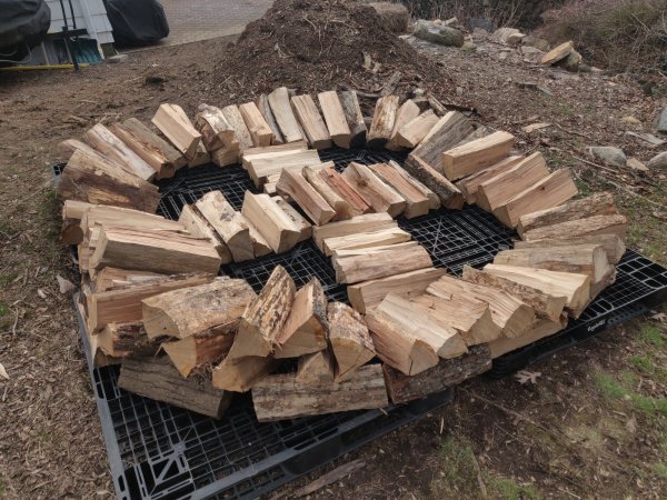

    1. Get some pallets. Important to get the wood off the ground. Besides preventing moisture getting to the splits touching the ground this also drastically improves airflow.
    2. Make a ring of firewood on top of the pallets. I use 4 pallets per hausen. Don't butt them up together tightly in order to maximize the size of the hausen.
    3. Place new splits perpendicular to the ring. They should all be pointing downwards towards the center of the ring. This is what gives the hausen its stability.
    4. As you start stacking, you will see that sometimes you lose that downward pitch. You can recreate that pitch by putting a split as a shim. Sometimes you need to do a few in a row, depends on the splits.
    5. I cover my hausens with a tarp that is 8' x 9'. It has grommets and I drilled a hole on the end of some splits and put "C" hooks into them. Space them evenly around the hausen. You just want to cover the top and a tiny bit
    of the side. Don't buy a tarp that is too big that covers the sides. You need maximum airflow.
    6. You can stick shorties and uglies in the center. When I first started building them I used to just toss them in. Now that I don't really have shorties or uglies I put regular full size splits and try to stack them tightly. You can stack them loosely if you like as that takes less effort.
    Things I learned:
    1. Do not use plywood pallets like the one in the first pic. I thought by drilling holes I'd help prevent water from soaking into it. Wrong. They fail and I had to rebuild that stack twice because that corner got completely smushed.
    2. I've transitioned to using plastic pallets. They are hard to come by for free and I was lucky to get as many as I did. So now I rely on one company who calls me every once in a while to give me one or two at a time.
    3. I don't cover my stacks until Sep or Oct of the year I'm going to burn them.
    4. I find making my splits rectangular in shape vs triangular works out better for stacking. Obviously I can't do 100% rectangular but I try to maximize it.
    5. Do yourself a favor and do in flat ground. When you have it on a slope maintaining that downward angle towards the center is harder.
    2020-02-27 13.29.08.jpg 2021-10-20 14.57.45.jpg 2021-10-20 14.59.31.jpg 2021-10-20 15.07.29.jpg 2021-10-20 15.35.27.jpg 2022-03-31 15.24.22.jpg 2022-03-31 15.24.25.jpg 2022-05-01 12.26.36.jpg 2022-05-09 15.58.57.jpg

    Thank you very much! Very nice how to! When I use 4 pallets, how tall should I go? Thinking 4-5 ft high? Do you know how much wood a typical haul will hold?

    You're welcome. 6-7' high. Holds over 2 cords for me, maybe 2.5 with tidy center packing. It holds a lot!
    Every 3 minutes take a literal step back and examine your angle. Make sure to maintain that angle.
