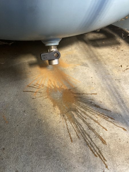

    I don’t do it religiously, but just did after i saw this.
