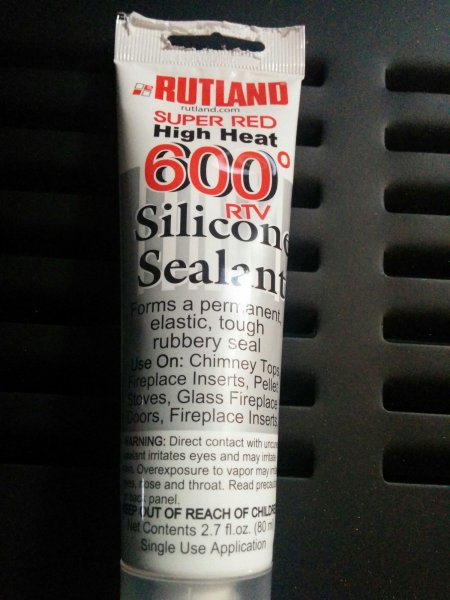

  13. Russell
    Russell
    Sep 9, 2015
    1,166
    5,631
    South Coast , Massachusetts
    ttdberg and imacman like this.

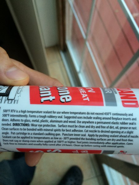

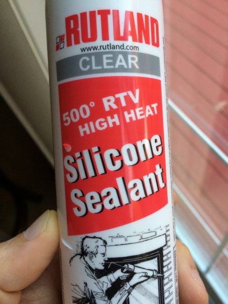

  16. Geek
    Geek
    Oct 10, 2015
    262
    601
    06770
    This was the best I found at local Ace...
